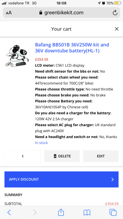

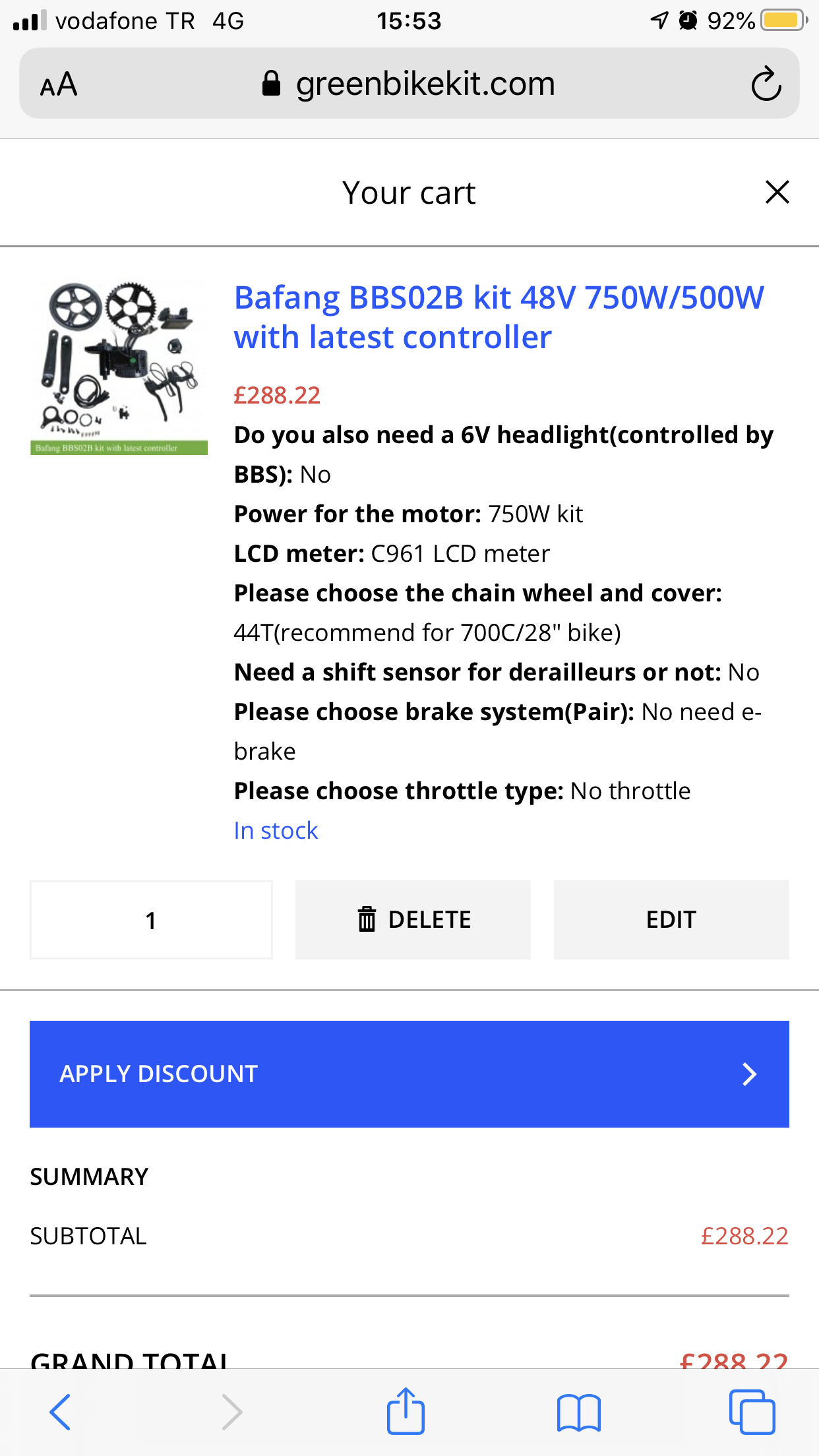

Just tried adding it to my cart to see how much shipping/tax would be and it asked me lots of set up questions. Dunno if I got them right.
avoid powerful crank motors.
They shed a lot of heat, unless you can keep your cadence above 80 RPM. Their controller is more fragile, dies more often.
They also require a very good battery to power them.
Stick to the 250W BBS01B.
