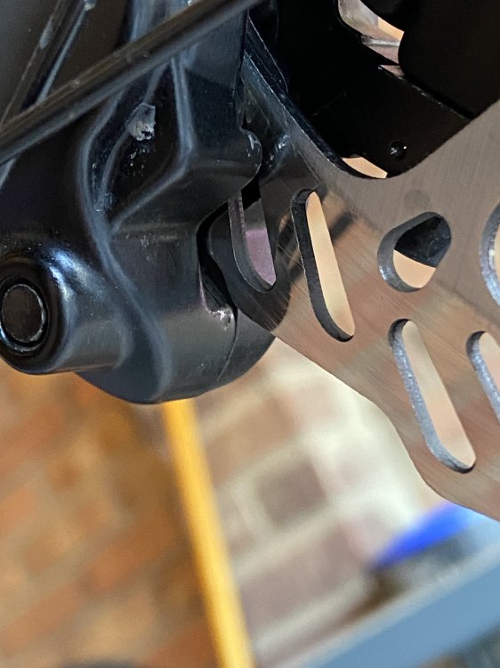

To me it sounds like the rotor edge touching the top of the calliper because the calliper is sitting to deep, try a thin flat washer top and bottom between the calliper and fork mounting.
You might be onto something there.
Just been out to take a look and there isn’t a great deal of space between the rotor and the caliper.
Looks like it may have been rubbing as there is a slight groove worn into the bottom of the caliper.
there is an ever so slight mark on some of the protruding edges of the rotor, not so easy to get a photo of on an iPhone though!
Having said that, since I last removed and refitted the caliper the noise has lessened slightly.
I’ll see if I can find any thin washers in the man cave later.

Quick update.
I have fitted washers to space out the callipers a bit. They have more than enough clearance now but are still grinding
think I’ll wait until I hear back from Claud @ Wisper!
The mounting adapter between the forks and the caliper is upside down.
Really? The arrow is pointing the right way
Fair enough, it doesn't look right to me.o_O.
They’ve all got their own little quirks!:p
That arrow is on the caliper. Look at what the caliper is attached to, that is what I believe is what wheeliepete meant, I do believe.
The mounting adapter ! A strong possibility....
I would not have noticed, he must have eyes like a Hawk!
regards
Andy
Nope, that arrow is definitely on the carrier.
The caliper is mounted to it behind the washers
Is the marking possibly misleading? Does the Disk Pad cover the right area on the disk?
