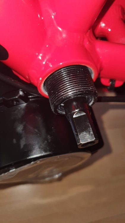

This is where it stops and doesn't go more in and becomes a bit stiff
Measure how deep it is from the bb end surface to the motor casing. Then see how far the motor will go in from the 'wrong' side. If it goes further than that then there must be something deep inside getting in the way. If it doesn't then the inside edge of the thread is the issue.
It only needs half a mm or so of a lump to be a problem, so once you find it, a file should shift it quite quickly.

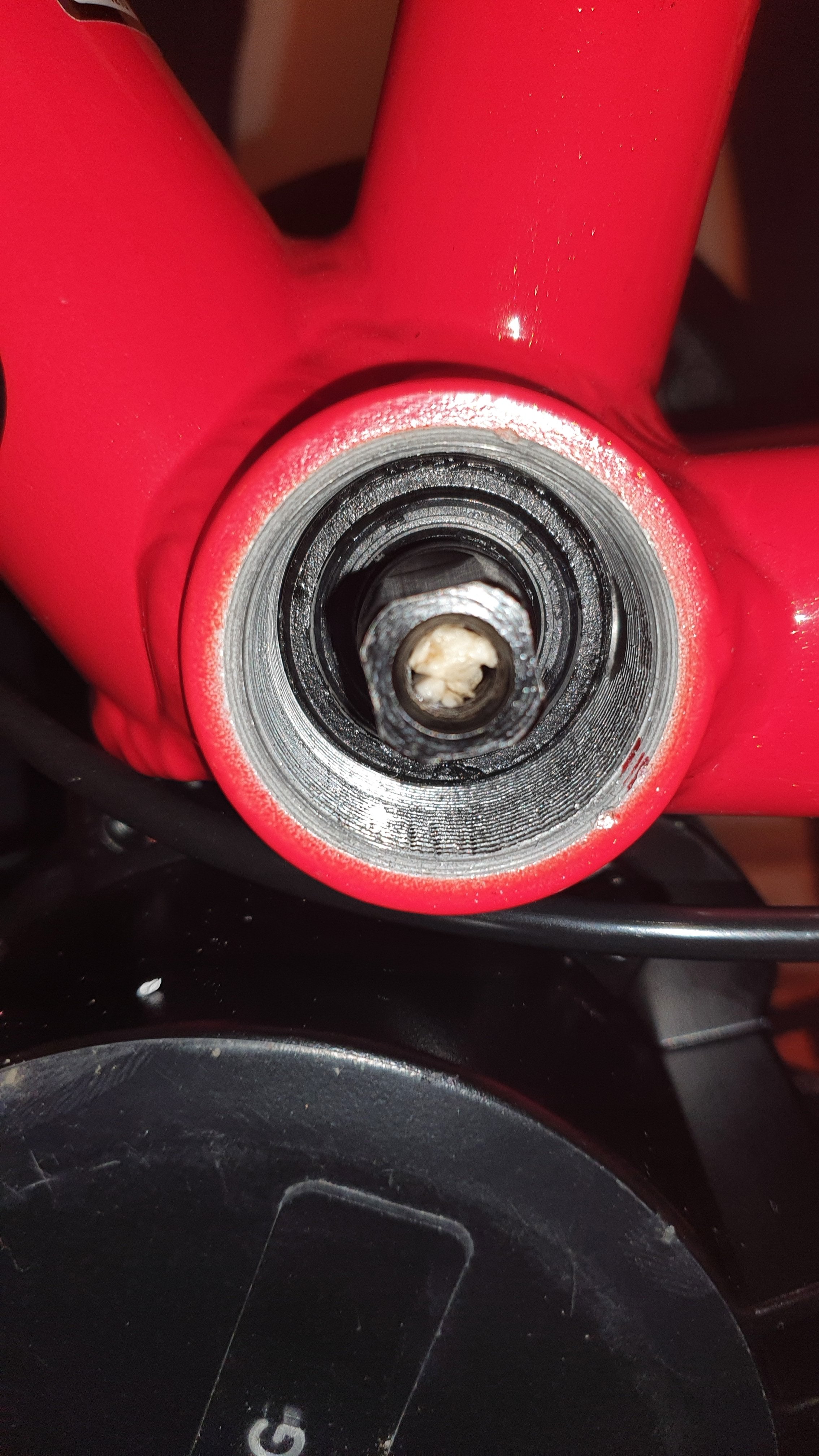

Also a pic of the other side from a top view with the motor inserted as far as it can go.
On the 2nd picture the arrows are indicating how much goes it and on the 1st picture is where it gets tight and doesn't budge in more
I'm currently waiting for amazon to drop off the the half round file also put my finger there it feels like a slightly little bump around that area which is probably why it ain't going in
Also my bottom bracket is 33.3mm inside shell but not sure about the middle bit
There is a ridge in the centre of the BB where the threads meet from each side. Remove this from around the circumference of the tube and your motor will fit without the use of a hammer.
Thanks for the fast reply i really do hope the half round file will do the job
It's aluminium, so quite soft and easy to file.
