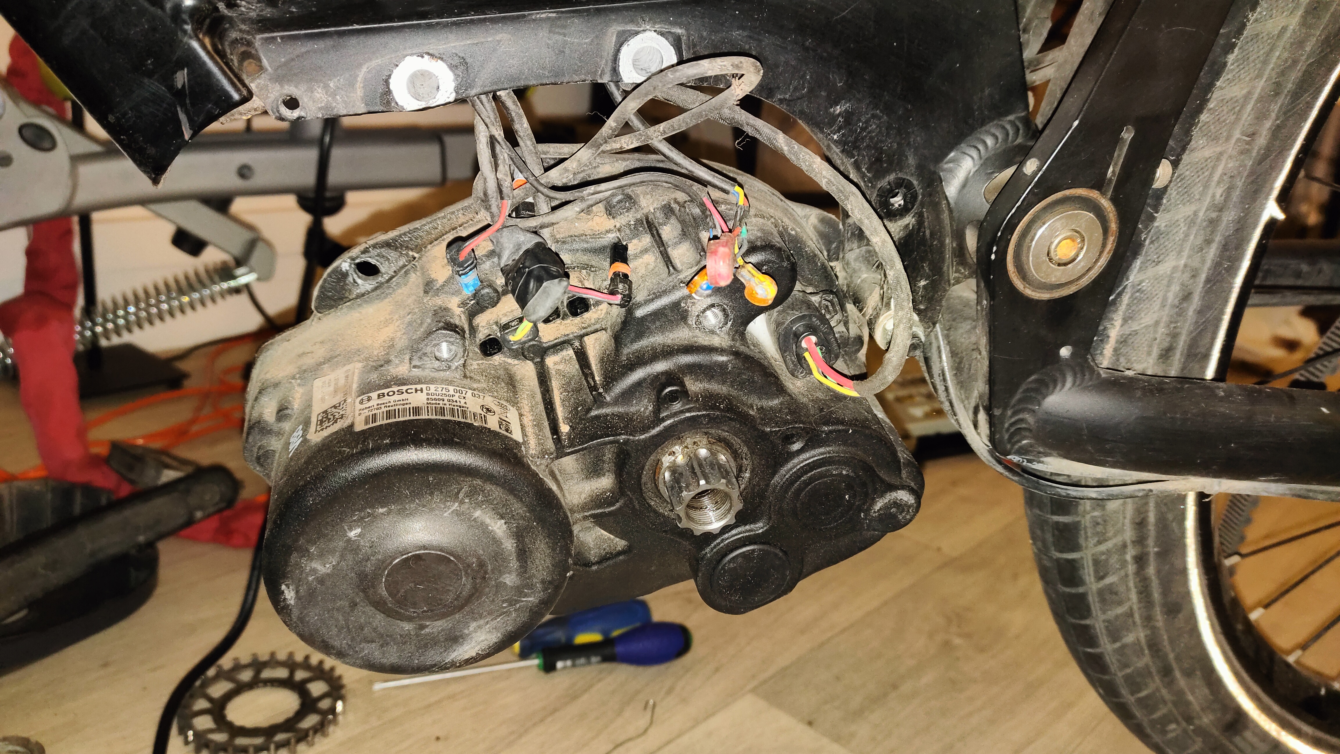

Somebody managed to open the gen2 motor without special tools and without damaging it? I saw one video, the guy is using special extraction tool.
Actually the motor is in this position to take it away from all the cables inside the frame.
IMG20230512214225.thumb.jpg.7b984a5d40bb6f0e7a465053327e34d3.jpgIMG20230512214356.thumb.jpg.6c8c31f87840b507c800db0068a8e692.jpg
thats my old performance motor but the same thing but when you remove the bolts holding the cover on you have to remove the cer clip or the right hand side so you can slide it over the motor axle.
that black thing at the bottom is the Torque sensor and held in plce buy a castle nut on the left hand side under a plastic cover.
