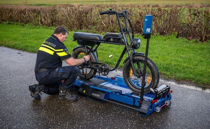

April 25, 20241 yr https://www.glasgowlive.co.uk/news/glasgow-news/glasgow-cyclist-caught-speeding-30kph-29051227 Blimey, 18mph. Absolute death machine.
April 25, 20241 yr Blimey, 18mph. Absolute death machine. Especially as up to 17.08 mph is allowed in the standard. I reckon that I could get the guy off in court if he used me as an expert witness. What the wheel spins up to with the wheel off the ground is not the same as the speed when riding because of the response time. Also, the display speed is not calibrated and unverified. It reminds me of the time the police seized a pedicab trike and grounded the whole fleet. They used a current measuring clamp over the battery wires to determine that 48v times the 25 amps that they measured was around 1000w and 4 times what they thought was allowed. I wrote a nice letter for the guy's solicitor explaining the errors, which was presented to the police, who then apologised to the guy and gave him his trike back. Edited April 25, 20241 yr by saneagle
April 25, 20241 yr Blimey, 18mph. Absolute death machine. Unluckiest ebiker ever. Swarms of youths with black masks on 1500w ebikes probably giving the Vs to the police as they zoomed past this incident.
