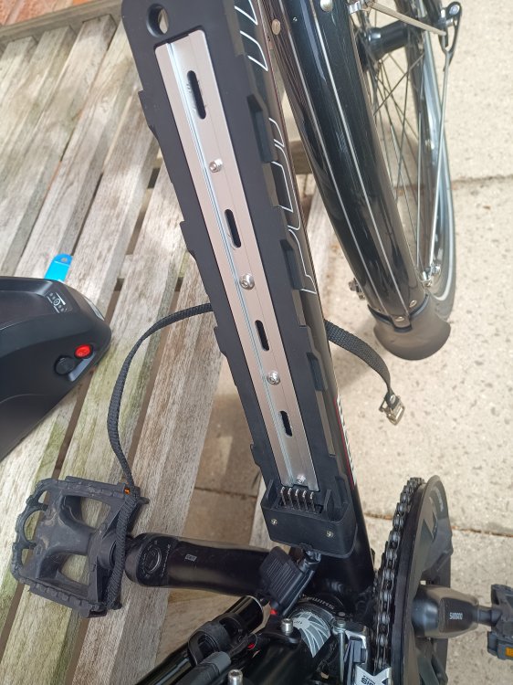

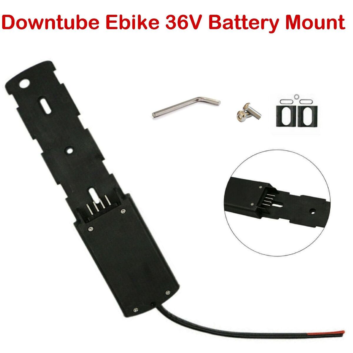

I've done that with the HL-1 bases and although it might help a bit I don't think it achieves much. It provides an extra fastening for the bracket to the downtube, but there are no plastic clips on the side at the controller box end to hold the battery to the bracket (see photo).
I've previously used two different types of downtube adapters, but these move the battery a few mm. up closer to the top tube - which is critical if I fit a taller battery.

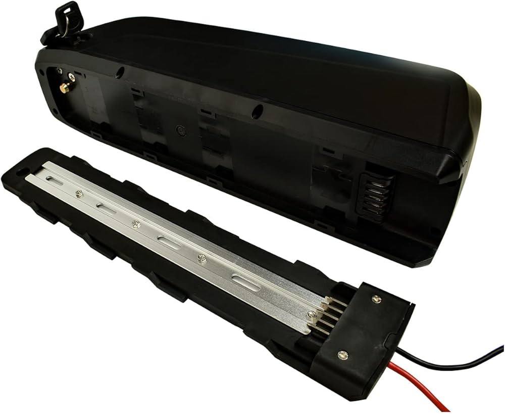

The G70 has four evenly spaced plastic sliding clips on the battery to fasten to the base.
HL-1BASE.thumb.jpg.8fb42c5161cbe096f2c9f6f8722160f9.jpgG70BATTERYANDBASE.thumb.jpg.b3f48bfad547333fe56ee1cafef0ad3d.jpg
The four slotted screw holes also give a bit more flexibility in where to drill for rivnuts.
I've done that with the all-plastic HL-1 bases and although it might help a bit I don't think it achieves much. It provides an extra fastening for the bracket to the downtube, but there are no plastic clips on the side at the controller box end to hold the battery to the bracket (see photo).
[ATTACH alt=HL-1 BASE.jpg]60684[/ATTACH][ATTACH alt=G70 BATTERY AND BASE.jpg]60685[/ATTACH]
The battery's weight is downwards. It rests on the connector, so screwing that plate to the frame helps a lot. You can feel it when you wiggle the battery with only the top two screws in, then do that again after the third is fitted. it's definitely a lot stronget and more stable. Also, it stops the whole thing getting ripped off in a fall. I've been doing it this way for ten years of moderately rough cycling, and I always jump off curbs. It might not be the very best solution, but it's more than adequate.

To conclude this topic, I finally pulled the trigger on a 48v 15Ah G70 Hailong battery from PSWPower. When trying to order on their website a message comes up saying they do not ship batteries to the UK. However, in response to an email request I got a Paypal invoice for £159.74. The battery arrived in 4 days with no further charges for VAT or duty.
The G56/G70 battery carrier has a full length aluminium rail that I was able to use without drilling my bike frame:-
I removed the two middle (of 4) small nuts and screws and the holes were almost spot-on for the bottle cage mounts, so I opened them out with a 5.5mm drill and slightly elongating one of them. I've tried mounting the battery and riding over some quite deep potholes - in conjunction with an old fashioned toe strap the battery is held firmly and doesn't even wobble slightly.
