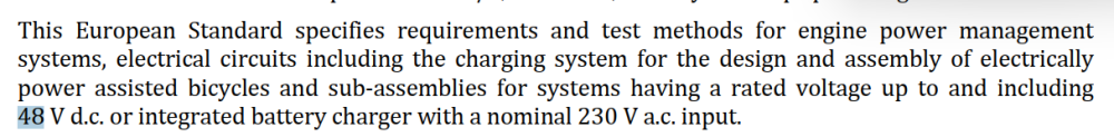

.........I'd like you to point out the law that states 52v is illegal though ....
As I understand it this stems from BS EN 15194 which is the European and British Standard for EPACS and defines the max voltage for an EPAC as 48v, thus running a bike at 52v puts it outside the definition so if riding a nominal 52v machine then it's an electric motor bike I'd think.
But I'm no expert on the EPAC laws as I always ride legal ebikes e.g 250w/36v/no throttle etc etc and therefore rarely delve into the finer points of the legal side so apologies if I've got something wrong here (and happy to be corrected - every day is a school day as they say).

There is a low voltage EU directive for DC powered tools etc,etc , with I think approx.70v being the max for hand held /usage items. However EAPC's weren't included in tha list and the max DC voltage for said bikes was set at nominal 48v.
