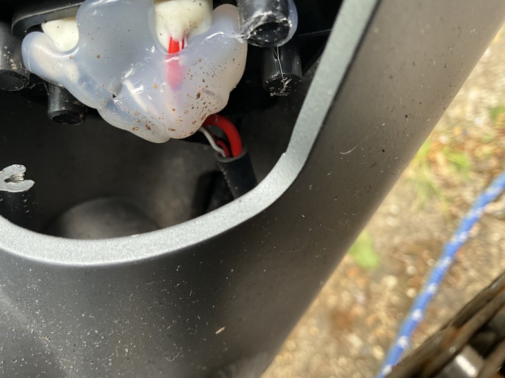

I have some photos definitely looks like comms wires in the back of discharge plug .
And some time ago when I did find the batteries on Aliexpress now gone they definitely said the Two sizes of batteries where not compatible.
Controller has a miniature version of Juliet so you can not see them that end .
I will just air drop the photos from my phone an attach them on here .
Morning

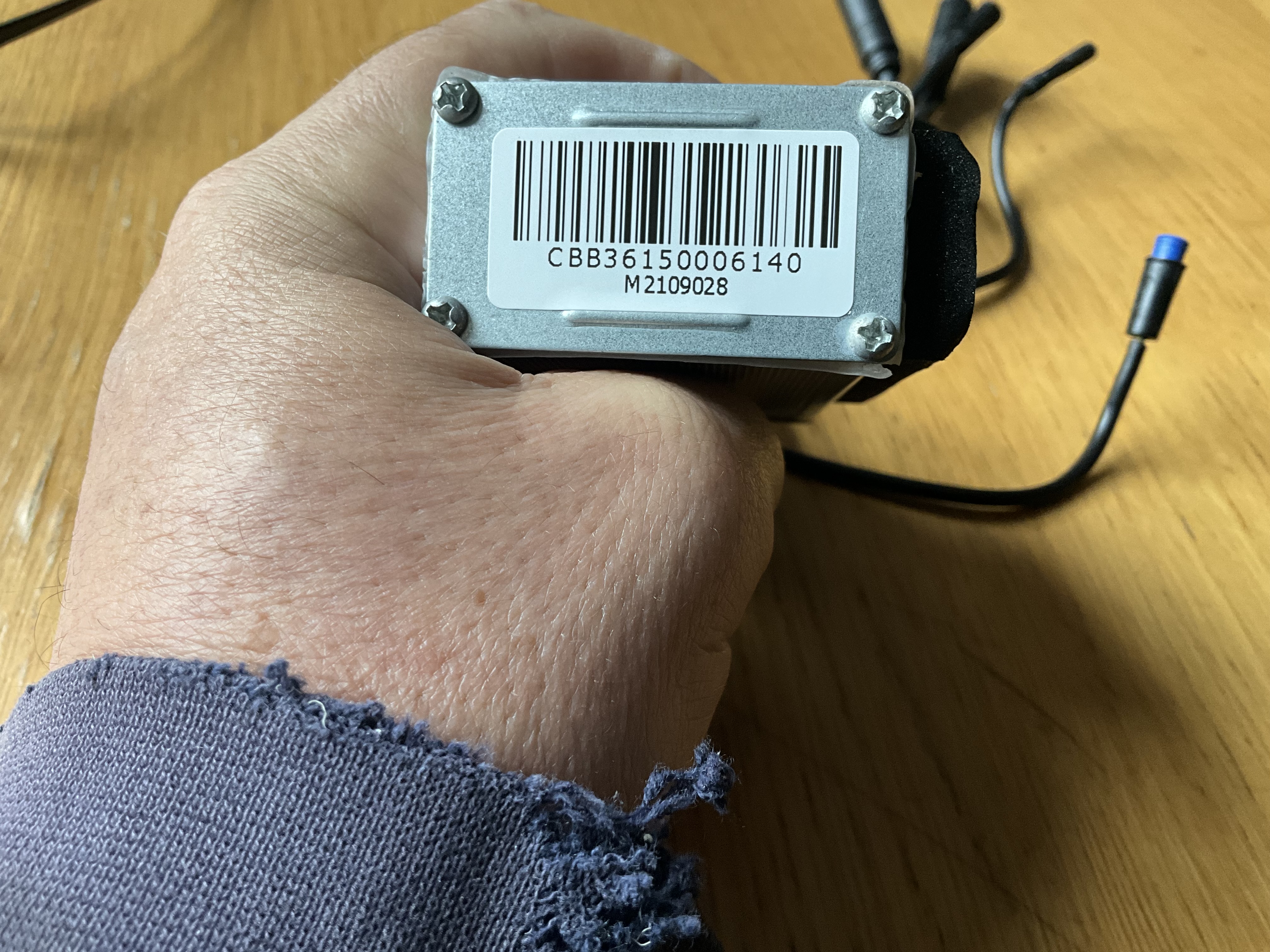

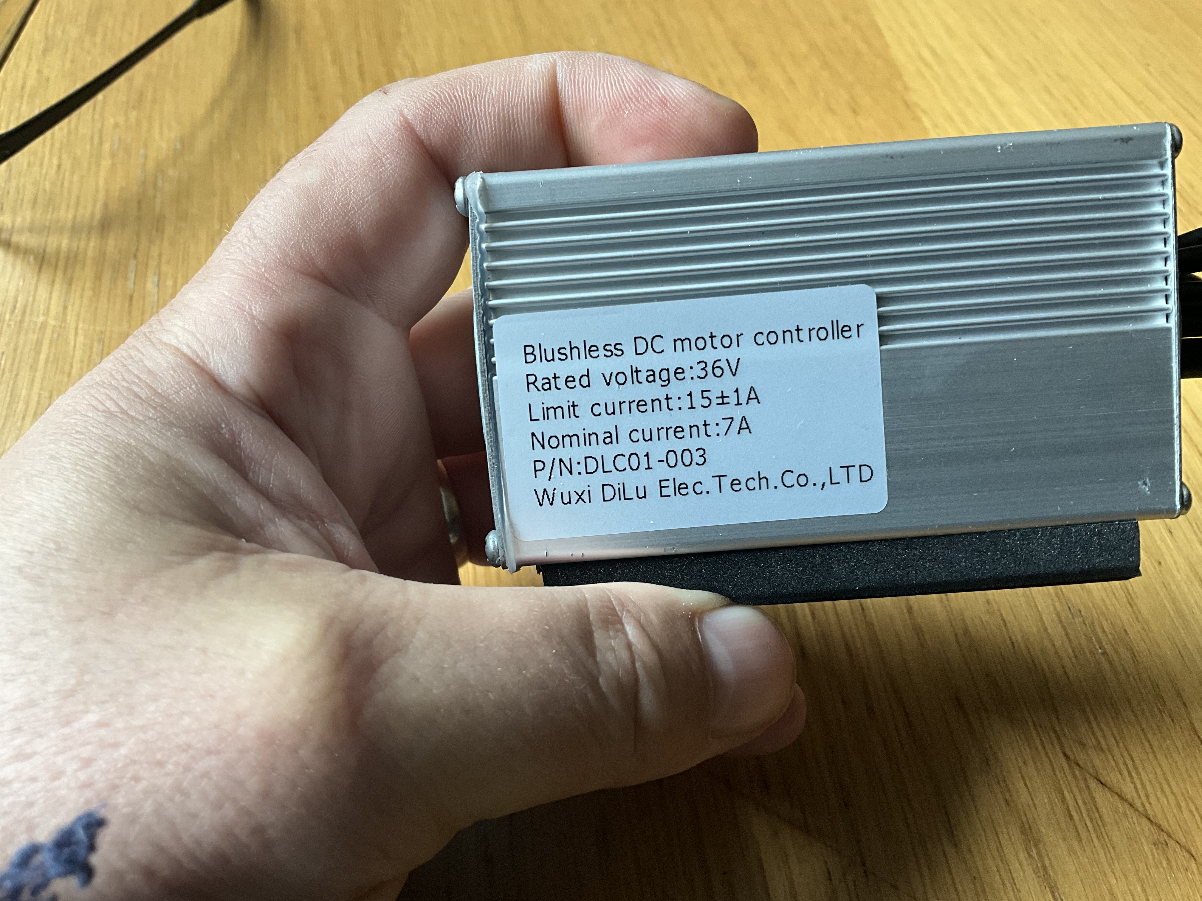

I think it has Canbus communication here are some pictures.
The battery plug also has multiple pins .
The LCD and PAS just seem to be small Julet five and three pin.
It has a separate alarm lead
Looking forward to doing something different with this bike as the Vanmooth style frame seems to be liked and popular.
Need to sell all the existing e components first to buy the new kit .
Just waiting for the battery guy in China to confirm the 14AH battery is standard comms though or it may be a problem then the whole bike will be sold as spares .

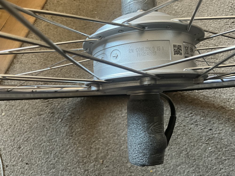

I just found out from reading a chaps add on GT that the Bird Bafang Rear hub is actually a 500W motor that is restricted I assume with the Bird controller which is good news so I probably keep it on the bike.
That makes me now wonder if the new 4 Bafang Rear hub motors I have in stock from the Somerby Pendalton old bike but new unused motors are also in fact 500W but also factory marked as 250W does any one know if this is the case ?
In my limited experience checking the motor drawings of Bafang hubs shows that the 500W and 250W motors have different dimensions. The 250/350W tend to be identical. You would of course have to know the model numbers to check this.

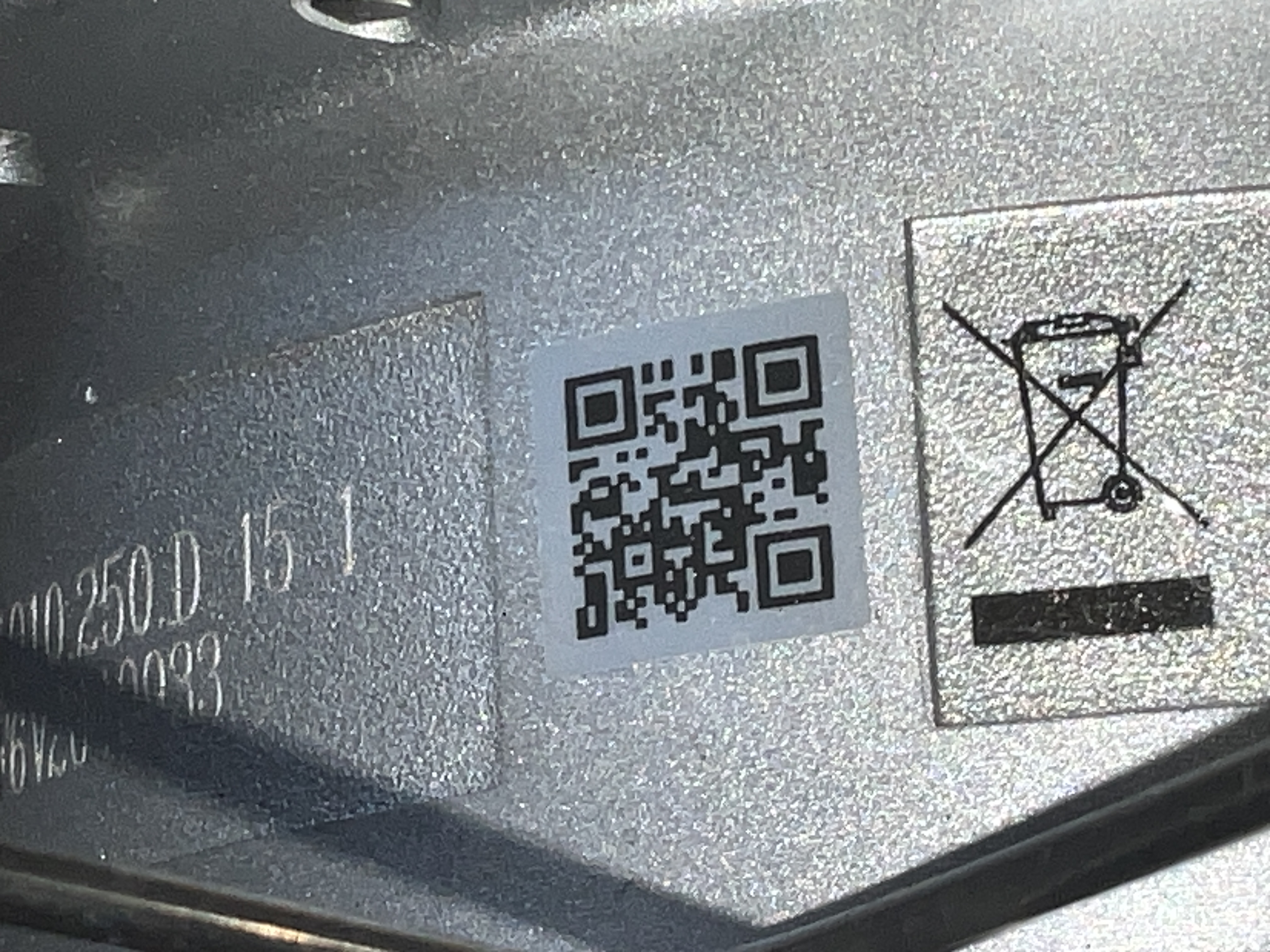

If you look at the windings inside the motor where they're terminated, you'll see that the wires are bundled in parallel. Let's say that there are 120 loops of wire around each pole. That could be 5 turns of a bundle of 24, 6 turns of a bundle of 20, 8 of 15 10 of 12, 12 of 10 or 15 of 8. Whichever it has, the windings would look identical, but the motor would have completely different speed and power characteristics. They also use slightly different thickness of wire to give even more combinations.
Bafang motors used to have the number of turns written on the outside of the motor, appearing as a number in brackets ranging from 6 to 16, with 16 being very slow and 6 being very fast.
Edited by saneagle
OK amI right in saying that the RM number CO10250D 15 1 under thatF6V2040933 are the number you mean so 15 1 at the end is the speed ?
I assume as it’s Bafang it’s a very good quality motor are they ok to go up to 48 V for a bit more torque?
