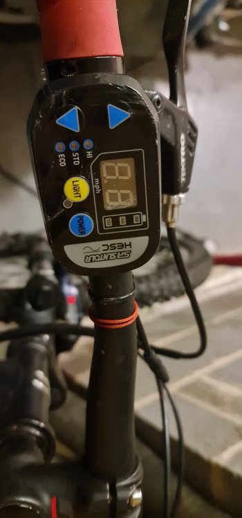

Does the bike have an LCD? If it does, please show a photo. I'm pretty sure that the Vengeance E never had a throttle. Is your a normal vengeance with a kit added? Please show some photos of what's on the handlebars, the area around the bottom bracket where the sensor is and the motor.
[ATTACH type=full" alt="63315]63315[/ATTACH][ATTACH type=full" alt="63316]63316[/ATTACH][ATTACH type=full" alt="63317]63317[/ATTACH]
That's the original Suntour HESC system AFAICS. I've never seen a throttle on one before. There's no connection for one. I'd be interested to know how it's been done. The controller needs two signals to give power. The torque sensor arrangement gives a pulsing pedal rotation signal and a 0-5v analogue signal for how how hard the pedal is pressed. A normal throttle gives a 1v to 4v analogue signal, which would work as long as you were able to spoof the pedal speed signal. I posted about how to do that a month or so ago.
So i gave the bike its first wash and noticed a few things, first is that it does not have a throttle, i think the ebayer just copied a listing then added his own details as the title says with throttle but the description makes no mention of it, i am ok with this as it would be an added complication i don't need, it does have a grip that rotates like a throttle but it just needs an allen screw tightening up.
