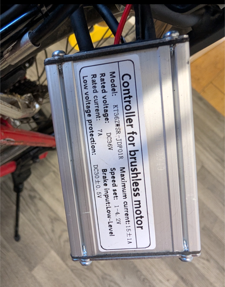

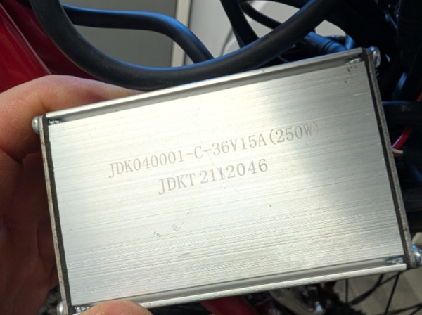

So where do I go now, I'm thinking the controller may be dead? How do I check it?
Can't find one anywhere with the same part number, except for the defunct cyclotricity one, but I can find some with similar ones, same connectors etc, are all these pretty much the same assuming I match the power numbers up? None of them seem expensive.

The fact the illegal throttle works (if beyond 4mph) and the PAS LED blinks on /off indicate the controller is fine .

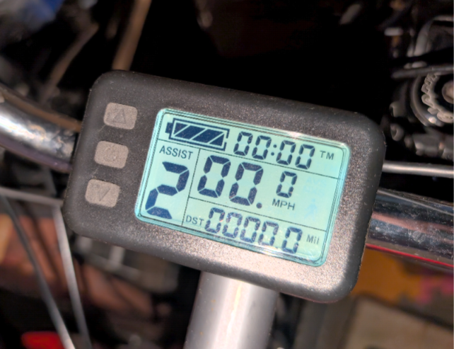

Your LCD1 is the basic model so one can't change any setting for a different PAS type (if used) .
I can get into the P1 to 5 settings with a bit of press and holding buttons but to be totally honest I've no idea what they mean or do beyond looking at them.

The LCD1 is the basic model which only enables P settings , these are factory set so should need no changes.

You already have the right controller. You just need to chance the LCD to any one from KT except LCD1, which is what you have. LCD3 is nice and clear. LCD5 is OK and probably the cheapest. LCD4 is nice and discrete, but the buttons are difficult to work with gloves. LCD8 is the easiest, but more expensive.
