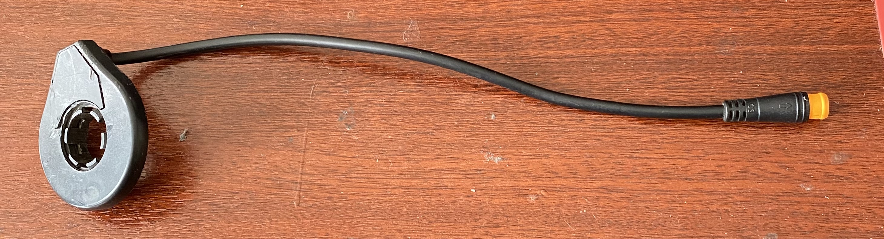

Can anyone tell me what colour wires does a SM PAS plug sensor has, so I can join a WP-90CM orange julet plug instead
like what colours from the WP-90CM orange julet plug join to SM black plug

this is an old PAS which dont work. so was thinking of taking off the orange plug transfer it to the V12 SM black plug which I dont need as mine is the orange plug type. I just need to know what colours has the orange plug one and what colours is on the V12 so i can join then correctly to work

Well in the orange plug one the 3 colours are black, red, & white

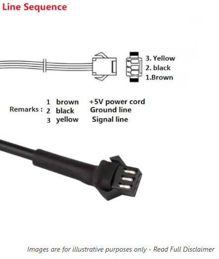

Interweb search claims this for a V12L
[ATTACH type=full" alt="63953]63953[/ATTACH]
thats handy to know so red black white on orange plug. so probably black to black , then just sort the other 2 white and red to either brown or yellow on SM plug can just temp join to test thanks for that
Black GND.
Red 5v.
White Sig.

Well Nealth that’s great as I just removed the heat shrink off the SM plug and they are red, black, and green so that’s easy then as orange wp plug is red, black, & white so it’s obvious white to green then black to black red to red great now I have a spare pas sensor
