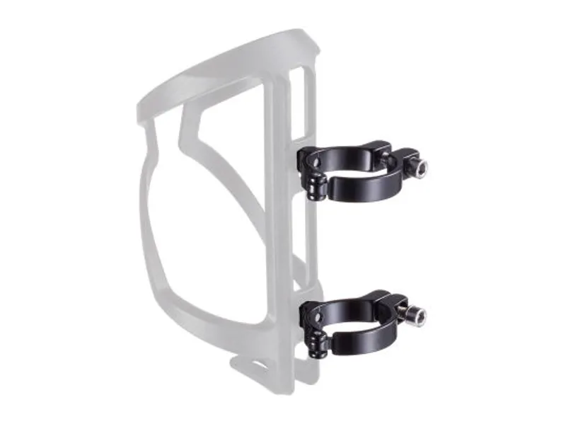

Wolf tooth do this, I have not used any of these:
Giant also do this
