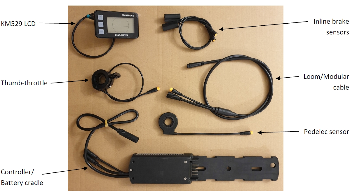

the manual for your headset found on the Woosh web site says err30 is a coms error with the headset.
with both my KT and noname controllers shorting the red/blue wires from the controller in the headset cable allow me to run the bikes headless (without a controller) @pas level1 and with throttle speed control (if fitted)
so if you remove the headset and short the red and blue wires in the connecting cable the bike should run without the headset .. Should allow you to validate everything else with the bike at least..
And perhaps open and clean the headset internals looking for obvious probs.
but where is the 40v coming from a dodgy power supply could easily be at the root of this error, I have no idea how the controller system initialises but with all the heavy drain electronic components fitted?? beg or borrow a 3 x car batteries to get a 36v source that can handle a significant drain if an ebike battery is beyond reach atm.

Might try shorting red and blue to see. Red being positive, blue showing as ‘lock’ Will Check to see if it is battery voltage or 5v before I do this though…
