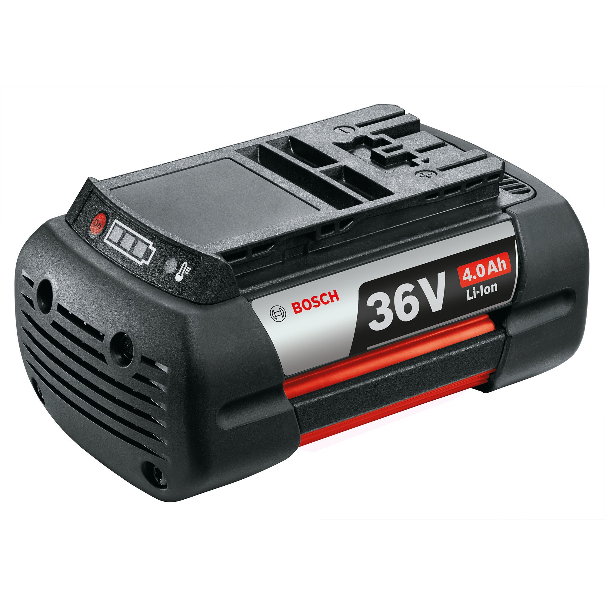

I had noticed that there are a number of adapters that allow you to use brand X batteries on brand Y power tools.
Is there one of those adapters that accepts the Bosch 36V batteries that could be hacked to be used as a holder for an eBike ?
Its the sort of thing you just assume; that someone somewhere makes and sells a battery holder for those Bosch batteries, but I cant find one.

Looks interesting, but very expensive. The module they have made seems to have a lot of other functions built in. If you just wanted to make an adaptor to take the battery, it probably wouldn't be too difficult to 3D print something.

You could even print a double socket, so you could have the option of having two batteries fitted at once.
I am concerned though about drawing so much current from such a small pack. I can't see it having a very long life, subjected to 15A draw and then recharged in 1 hr at a C1 rate.

The batteries in the 6Ahr pack do have a 10A rated charge I beleive, so should be OK for 15A.
As for routinely doing a 1hr charge, you would think that is going to 'quickly' reduce battery life, but then if you have a holder, easy enough to use your own charger.

6Ah is getting a bit more sensible, a lot of e-scooters have a 7.5 Ah pack. But 2.5 Ah, or even a 1.3? Good point, you could 3D print your own charger housing and charge at more reasonable rates.
With a project like this, you could easily take your pack into a coffee shop or whatever and plug into any modern USB port and recharge opportunistically.

Those tool batteries are made with chemistry to allow fast charge.
