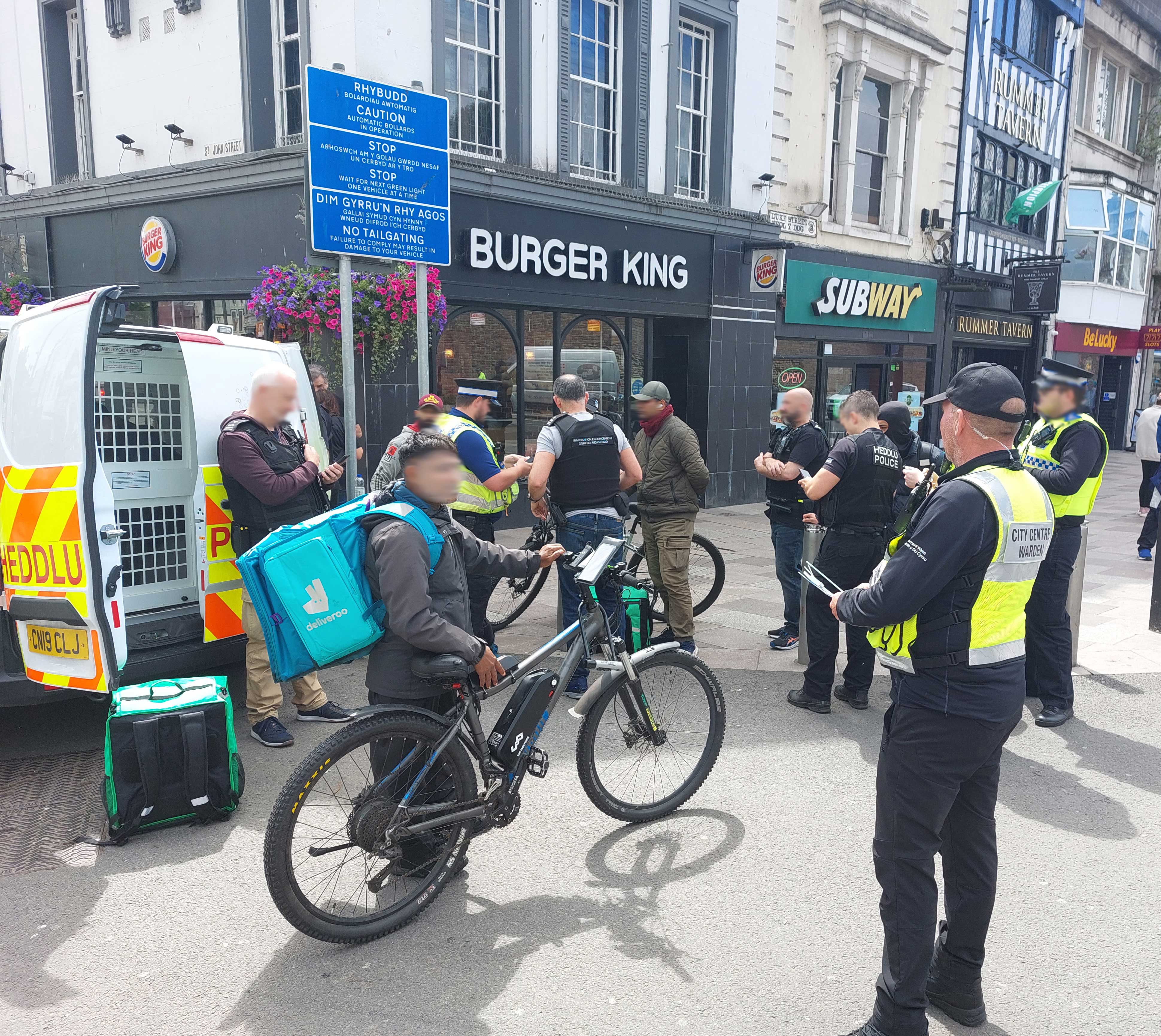

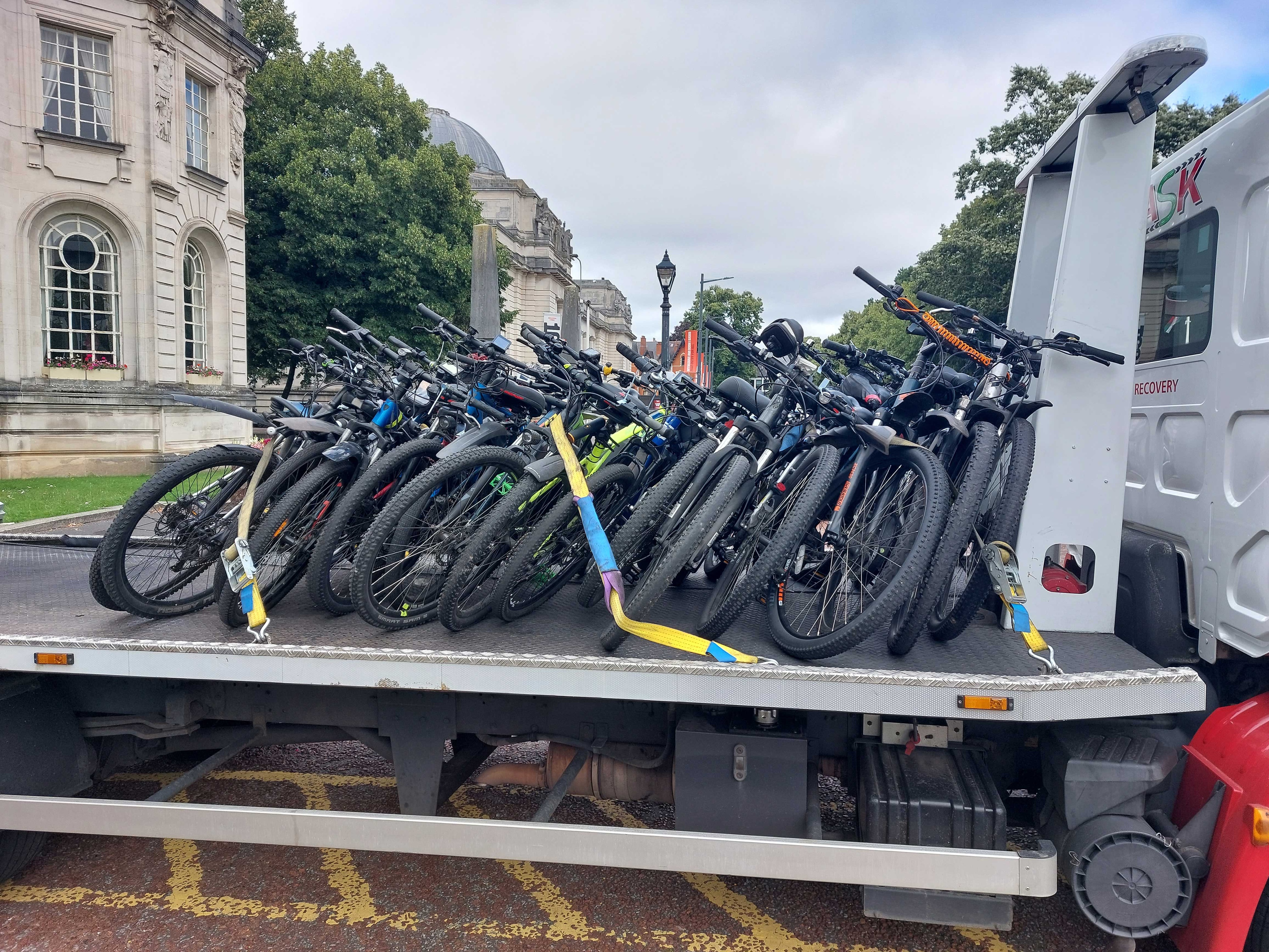

Two Bafang mid motors! (Cardiff crackdown post #60)
No front hub motor in sight:
21,760
8,842
Looks like a good few fastfood menaces being taken off the road, maybe next time they will stick to legal type kits.
The last pick looks like a normal rear geared hub but like most of these bikes they will have a twist and go throttle or simply no speed limit.

The bottom picture is the entrance to the Queen street pedestrian zone, its where the Ninjas congregate for pickups.
12,235
3,411
"Over the course of their operations, the council and police have pulled over and spoken to 1,300 people, 70% of whom were riding illegal electric bikes. "
That's a lot of Rinjas.

It is, I recall mentioning on here some time back that catching the Ninjas is easy, the Police just needed to hang around the take-a-ways in a city centre and that was the exact location I was on about.

Cardiff police confiscated 17 bikes, they are all capable of 30+mph. Let that be a warning.
