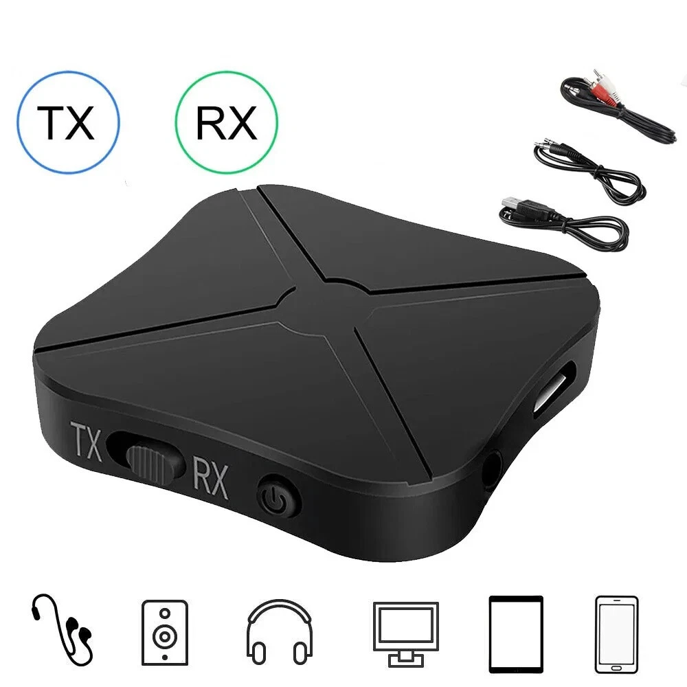

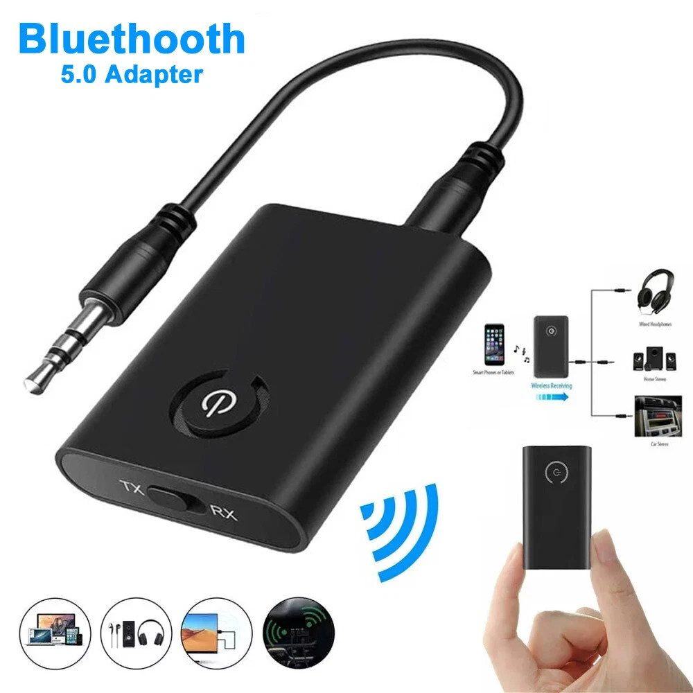

My Sennheiser RF wireless headphones are ace, but I like using neckband "Sports" bluetooth headphones sometimes, when pottering aound doing physically intensive things, because they don't fall off. Also, on-ear headphones get sweaty. So I thought I'd try listening to my HiFi via bluetooth, bought a couple of these cheapo transmitters, but they are noisy when connected to a USB power supply:
https://www.ebay.co.uk/itm/315356226866
https://www.ebay.co.uk/itm/364921032300
The good news is, they pair fine. Sound quality is just about bearable with tweaks along the line, but hardly audiophile, but £9 Asda bluetooth neckband earbuds (on sale for £4) can't hold a candle to my seriously wonderfully awesome Sennheiser HD600 of course, but now I know these pair with generic transmitters, I can buy better bluetooth earbuds.
...but there's godawful interference noise from somewhere, when not operating on internal battery... until I bunged these onto the USB power cable:

Oh and the two devices above automatically pair with each other, to transform your better headphones, or whatever else (other hifi, bluetooth speaker) you've plugged in, to bluetooth - simply set one to transmit and the other to receive.
The batteries in cheap stuff like this die a quick death, but when that happens they're easy to replace, or they work on external power (hence the importance of low noise) if you rip the batteries out.
