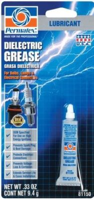

You don't need waterproof ones. Just put a dob of silicone grease in them, which will be more waterproof than the waterproof ones.

Thank you - it just so happens I have one to test and torture. I'll order some dielectric grease.

Brilliant. It'll turn your connector into a capacitor, so your bike will run smoother.

Is that not the right stuff? I'd hate to have an even smoother running bike. I'm not sure I could cope.
