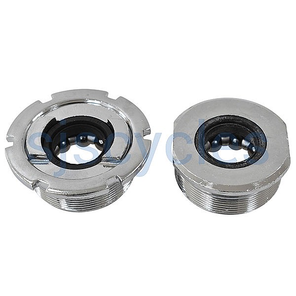

The reason cup and cone type bearings are more common is because they are cheaper and are stocked on cheaper bikes, which are more common. Sealed bearings are better for longevity and require less servicing than the cup and cone type.
Saying that though, a cup and cone type bearing will last just as long if not longer than a sealed one, it just requires a thorough cleaning and regreasing the minute it starts feeling gritty.
Unsealed bearings also roll faster.
trex
May 15, 2011
7,703
2,671
the reason for using cup and cone BB is not so much because they are cheap but because of the longer BB shell length on some frames, especially when the battery is behind the seat post. You can't find BBs with sealed bearings for shells longer than 83mm. The old design lets water in, causing loss of lubricant. The more up to date cup and cone type now has much better water barrier, so there is now not much difference in longevity.
