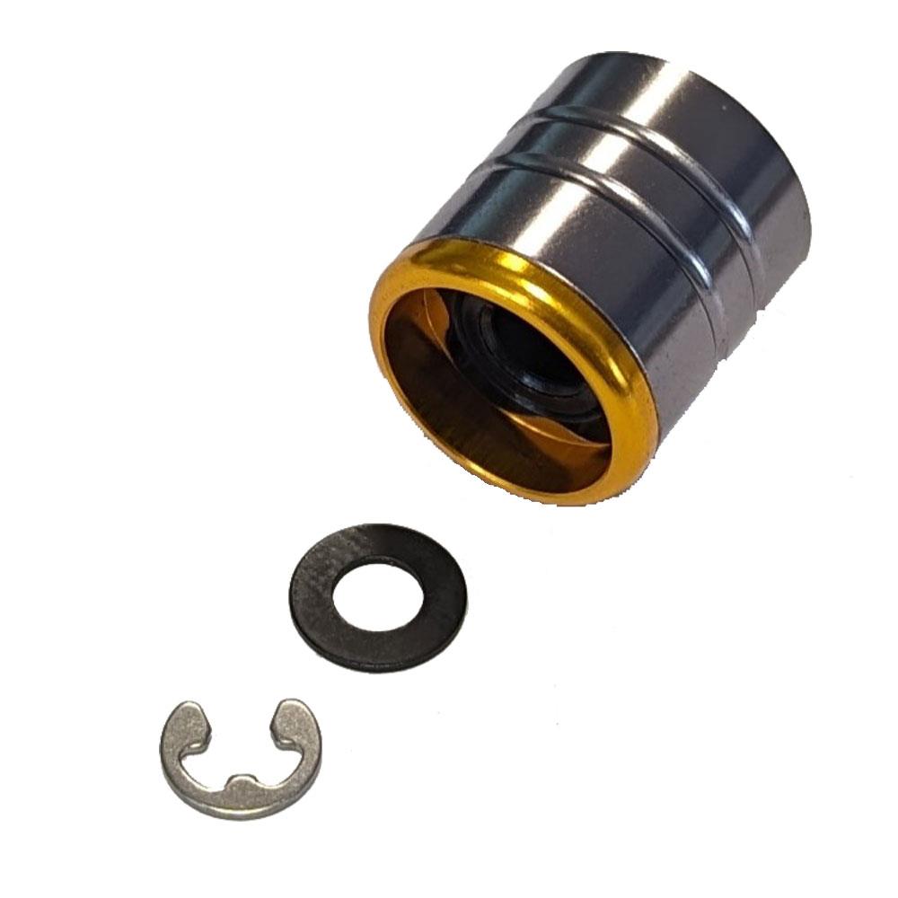

What's that thing in the photo with a circlip in it, then? It looks an awful lot like this to me:

Yes, it's a QR 12 mm through axle bolt for Suntour forks
