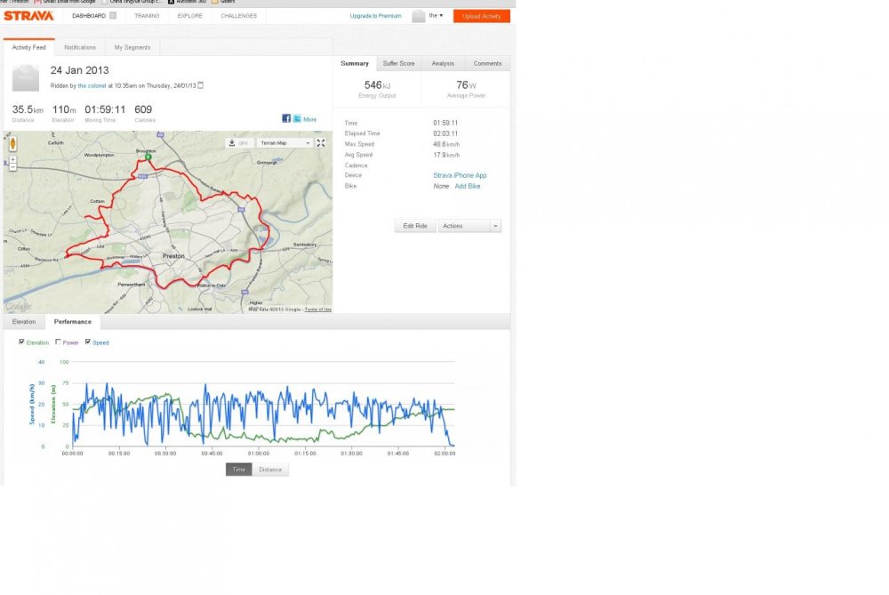

The second ride was around the Preston “Guild Wheel”, a 21mile circular traffic free route around the periphery of the town, completed to celebrate 2012 Guild year (Guild celebrations only occur every 25 years!).
Again weather was 3degC, little wind but some snow/ice on the ground, again on maximum assistance. This was a potential route to take my non cycling wife on, so I wanted to test out the throttle only capability. I started the route on the northern outskirts at Broughton traveling on a clockwise circuit. The route to the east undulates before dropping off an escarpment down to the River Ribble. From here the route follows the river for approx 8miles as near to flat as you are ever likely to get. This was ridden on throttle only. By the time I reached the docks to the west of town, the battery indicator was still showing 3 lights with the occasional drop to two on any ramps. The route from the docks back north to Broughton undulates and was ridden with pedal assist. I was down to 2 lights when I got back to the start point. The battery took 5hrs to recharge. Considering I rode 8 flat miles on throttle only of a total 21miles, I was quite pleased with the results knowing my wife should be able to accompany me on this level of ride.
[ATTACH]5008.vB[/ATTACH]
