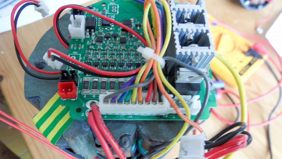

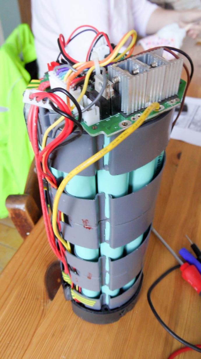

Hi all, has anyone got a few mins to have a look at this issue:
My kit with bottle battery has just stopped working the other day, just cut out mid ride at the top of a hill climb. It has done this once before but after battery dismantling & putting back together it seemed to work again (I didn't do anything really to it).
The fault seems almost identical to this thread:
http://www.pedelecs.co.uk/forum/electric-bicycles/15522-oxydrive-battery-seems-dead-what-do-2.html
After reading d8veh's replies I tried his various suggestions & have come to the conclusion that 1 or more of the cells is dead or very low.
Voltage across the whole pack (inc BMS) is +1.5V p- to p+
Voltage across battery is 36.5V b- to b+
The voltages on the balance wires are 4.1; 3.5; 7.7; 11.8; 15.9; 20.0; 24.1; 28.2; 32.4
am I drawing the right conclusions about the cell(s) condition?
I've been trying to work out how these packs are put together, there are 40 cells in total each giving 4.1 v so is it wired 10s 4p? that doesn't seem to tally up with there only being 9 balance wires.....not sure about that.
If so taking these things apart to replace cells seems tricky & is it a good idea, not sure about the quality of the pack now as I've only done about 1000 ish miles.
Any insights or help much appreciated.

Interesting BMS! Do you know what thr discharge rate is?
The packs are normally 10s4p, so you need 11 wires to measure the cells. The remaining two wires must be the two thick wires from the top and the bottom of the pack. Put your black probe on the black pack wire (B-) and then probe each of the nine balance wires plus the thick red (B+) to get 10 incremental results.
The results you have given don't look right. It shouldn't be possible to go down in voltage incrementally.
Thx for the reply d8veh, checked again on (B-) (its one of the yellow wires on this pack) to (B+) and that gives 36.5v, all the others are the same as before.
Not sure about the discharge rate, sorry.
Edited by alemanyorks
From the results you've given, one of the cell-strings is definitely faulty. All cells are at 4.1v except one, which is - 0.6v. Follow the wire to find tje group. The repair will be difficult unless it's the balance wire that's come off.
Thx for your opinion & help d8veh, I may do some careful un-soldering so see what its like & also start thinking about other alternative replacements.
Ah that's just what I needed THX, must have missed it on a search through. Does seem pretty involved but could be well worth giving it a go as I have some new laptop cells which will fit. What sort of soldering iron power do you use? as I have a very small one which probably wont be upto the job.
You need to check the capacity of your laptop cells match your bottle battery ones. An 8.8 ah bottle battery will have 2200 maH cells. Look at the label on your laptop battery, and then divide the total maH by the number of cells in each string. Older laptop cells have 2000 maH or less. Sometimes, a lot less.
You don't need a specially big soldering iron. Any one should do as long as it's not too small, so 30w upwards.

I've had a look at the cells I have & think they are 2600 mah (10.8 v 5200mah 6 cell laptop pk) so looks like i'd have to do the whole lot, quite a bit bigger project than I was hoping. I may still have a go(I have enough cells) but get something else in the meantime to get me up & running again.
I think I'll start another thread about that.
Thx for the offer KirstenS but the ones I have a brand new & all the same so should be fine if/when I use them.
I don't see why those cells shouldn't work if you just replace the faulty string of four cells. I would be more worried about using worn out cells of lower capacity.
