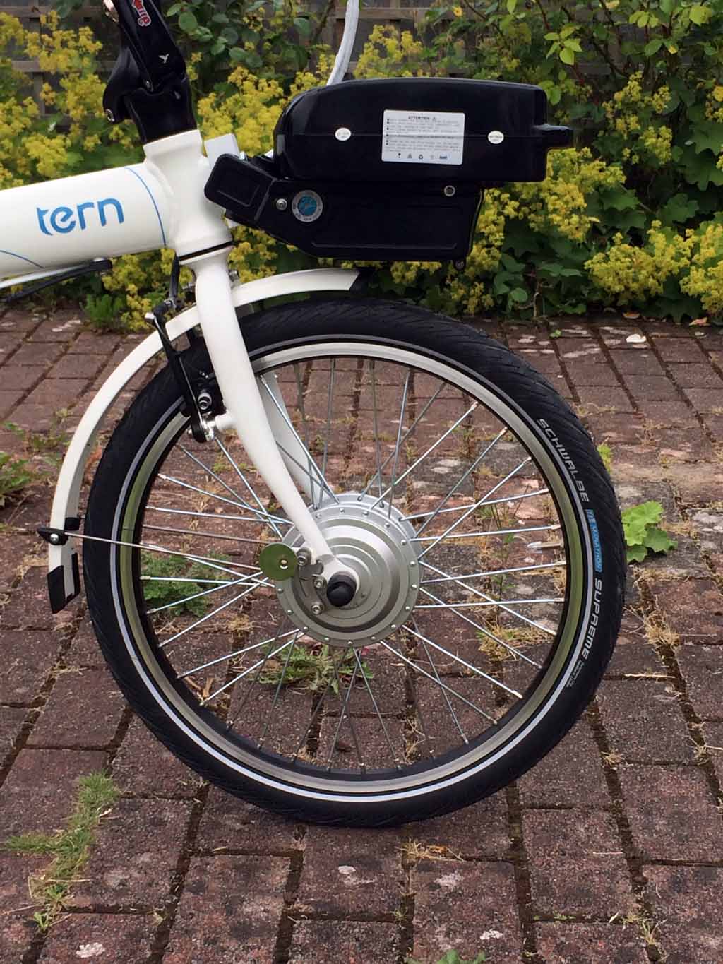

Just to update on my conversion of a Tern Link P9. I'm banjaxed at the moment because my supplier sent me the wrong charger so I can't wire everything up.
The attached pic shows the motor and battery mounted on the front of the bike.
The bracket has been successful and the frog is mounted very solidly and securely. The only slight issue is that it doesn't turn with the handlebars which just takes a little getting used to.
I've tried the bike a few times with the battery mounted and it still rides well and easily even with no power. It's a little nose heavy when carrying but not too bad.
The other day, I gave it the full beans starting on a hill with no battery mounted and the front wheel bunny-hopped so maybe a bit of weight over the front won't go astray.
Hopefully I'll get the charger in the next few days and start wiring up - and yes, the wire going into the hub is pointing down as it should be.
Thanks for all the help and advice so far.

No significant markings on the motor. Ciclotek is etched on the side but they've obviously put that there themselves. There's just a 36v 20" sticker on it and a serial -type number etched on as well. Does MX03 mean anything to you?
Yes, MX03 is a MXUS MX03. It's similar to the Cyclotricity motor, which is the later and slightly more efficient MX07 (IIRC), which also takes a disc brake. They're nice motors. There's two versions of each. They put stronger magnets and higher grade wire in the European ones compared with the ones for the Chinese market, which gives a bit more torque. Which one you get depends on whether Ciclotek bought them direct from MXUS or from a Chinese agent.
