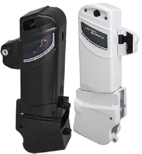

October 18, 201510 yr I have only managed to find two threads relating to this bike, both of which were dead ends. Looks like the Fast4ward Edge folder is almost identical to the A2B Kuo..but I can not be sure. The Edge has a handle bar display, but I can not see one mentioned in the Kuo pdf manual. Someone brought one of these in for me for repair. Battery was entirely dead. Even the OEM charger would not come on line and bring it back. Guess the bike had been left on and / or the BMS draining the pack. Opened the pack up and see it is standard Sony CGR18650CG's, a 6s4p pack giving nominal 24 volt 9 Ah Gave it a slow 0.1 amp charge, direct to the cells, while monitoring cell voltages. Slowly brought the pack back to life, and BMS cam back on line and allowed the OEM charger to work. After a good 12 hour charge, the SoC indicator shows full, and Green OEM charger light stays on green. The pack has two main terminals and also a smaller 'signal' pair. Anyone know what these are, ? Problem with this bike is that it is 'dead' no motor activity. The is a handlebar display with a single central button. This display comes on line when powering the bike on from the battery switch. The writing/ diagram on the display indicates that the button should cycle through 6 display options. But pressing the button does nothing. The display just sits there displaying 21 Cycles. Well..it says 21 on the display, with a small label at the bottom saying "cycles'. Is this really a 21 cycle indication ? or perhaps an error code? like the Bionics? Neither PAS or throttle make the motor activate, in any of the 3 position switch positions. Slow, off or high. All connections and plugs seem sound but more than that not started hacking in to the wiring loom or probing with a DVM yet. Thought I'd wait to see if any one had any hints /advice on this bike. Thanks Neil

October 31, 201510 yr Just spotted your post. The key lock just holds the battery and has no switch . The smaller pair of battery terminals send info to the display, In turn, battery voltage, temperature, and number of cycles charge/ discharge that the battery has gone through. The display does not show fault codes except battery error and empty alarm. Yours has been charged 21 times so almost new. The display clips in to it's base, check that all six pins are clean and making contact and the display is pushed fully home. The button scrolls between battery % left, volts, temp, mph, kph. A curved bar display shows battery state . Cable from display are orange- earth, brown- DQ data, red -anode, black- cathode, yellow- speed sensor, green- speed sensor. The display tends to default to cycles from speed if you stop. Can be a bit random sometimes . The controller is a bit vulnerable low down so check for water ingress. The edge and Kuo are virtually identical.
