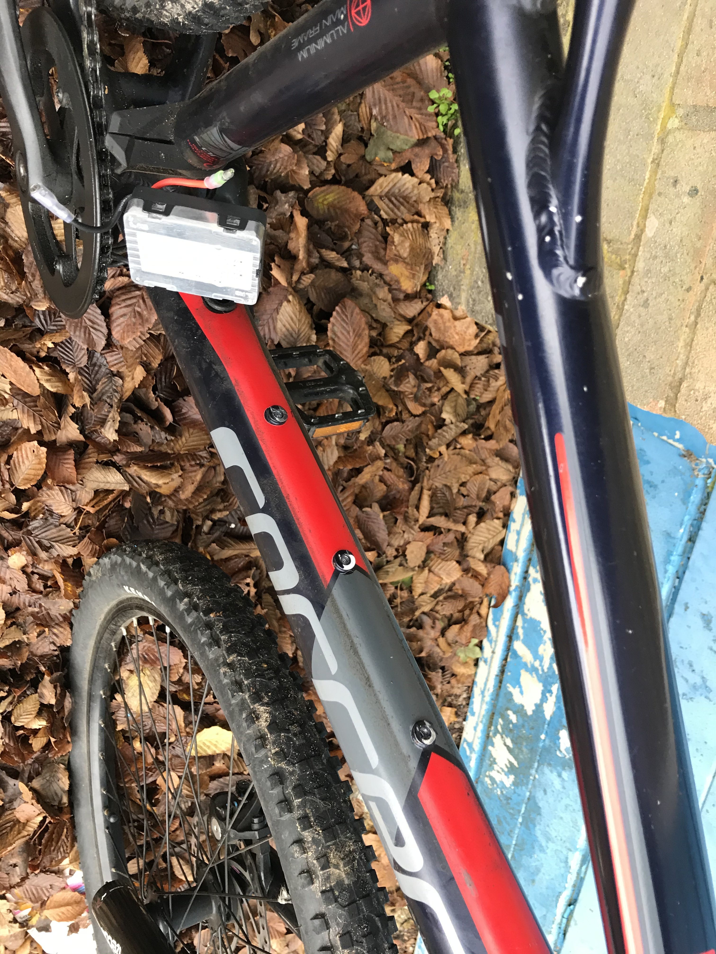

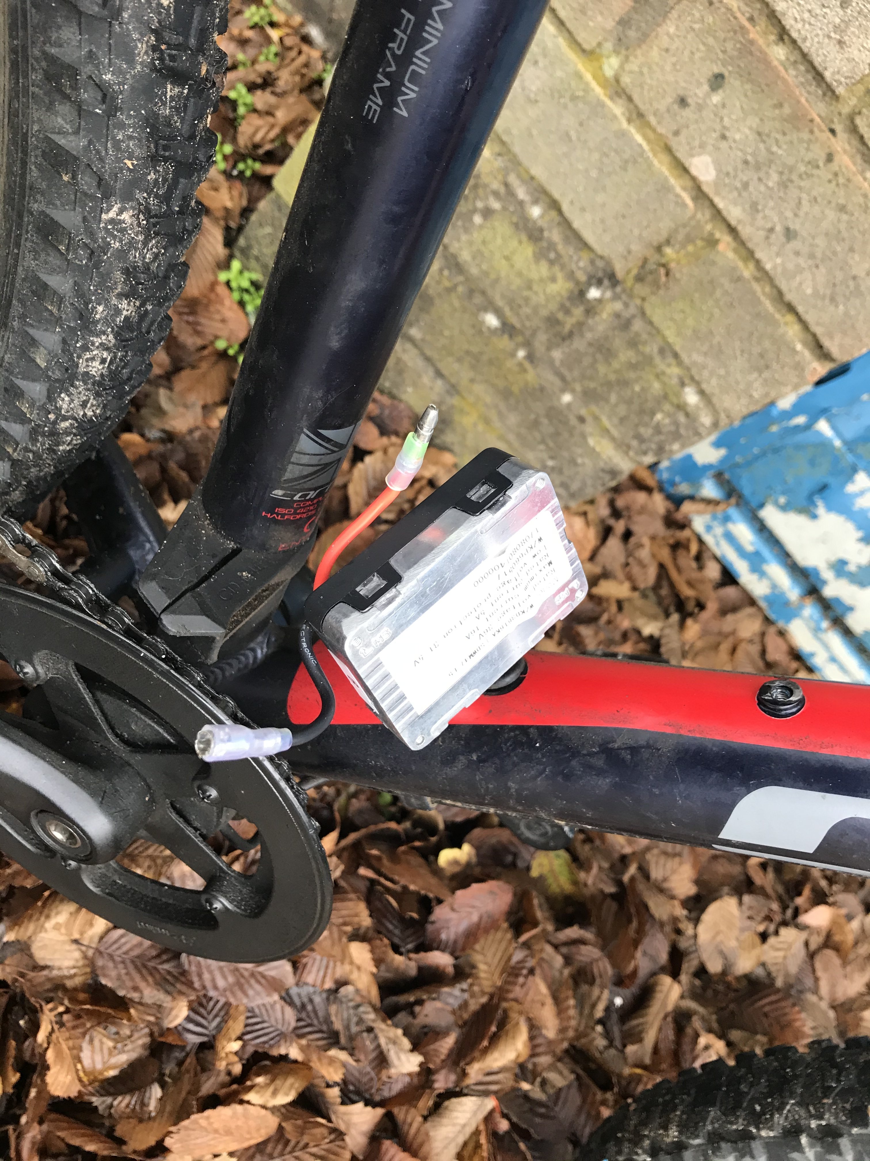

November 11, 20205 yr Author I will pop out again for measurements but here are the arrangements- keep in mind this is a small frame as I’m 5’3 - the old battery plus case for the controller is about 35cm.

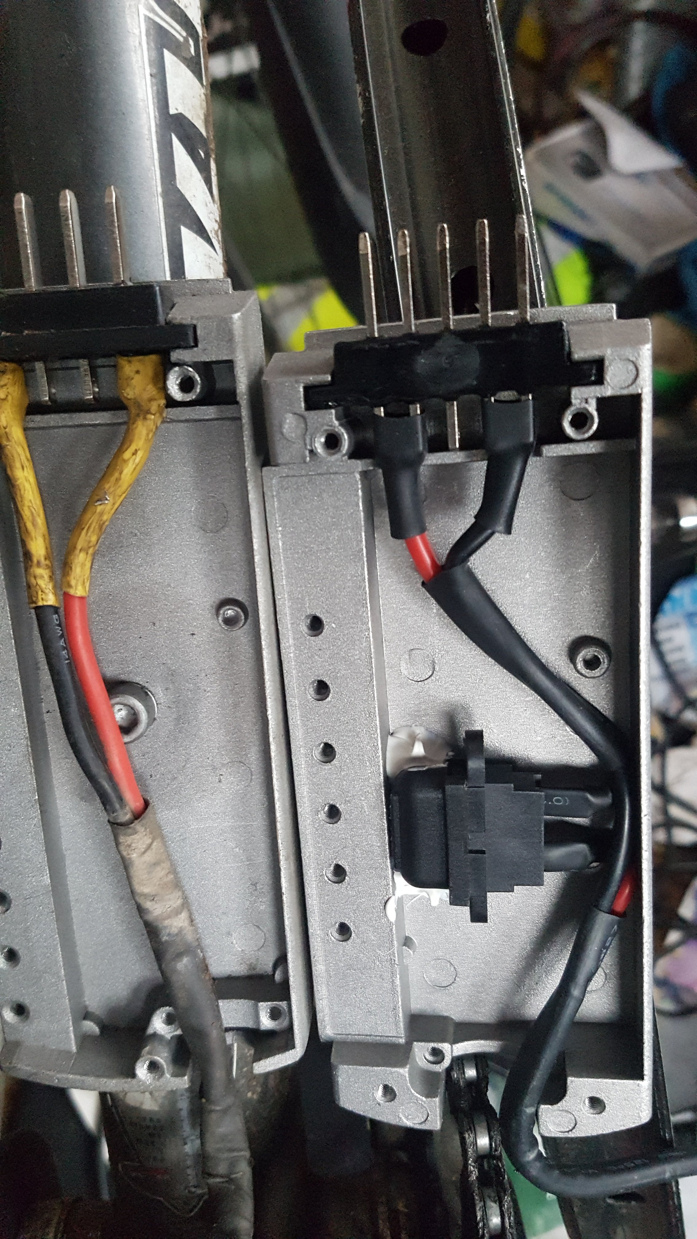

November 11, 20205 yr that's good. It already has three well-positioned fixing points. If you use a Hailong type, you can drill through the aluminium plate at the bottom for the bottom fixing. It's a bit awkward to mark it for the correct position to drill. These are the two different plats. You can see that the one on the left is attached to the frame by a cap-screw right in the middle. I have a 6mm rivnut in that position because I ran out of 5mm ones.
