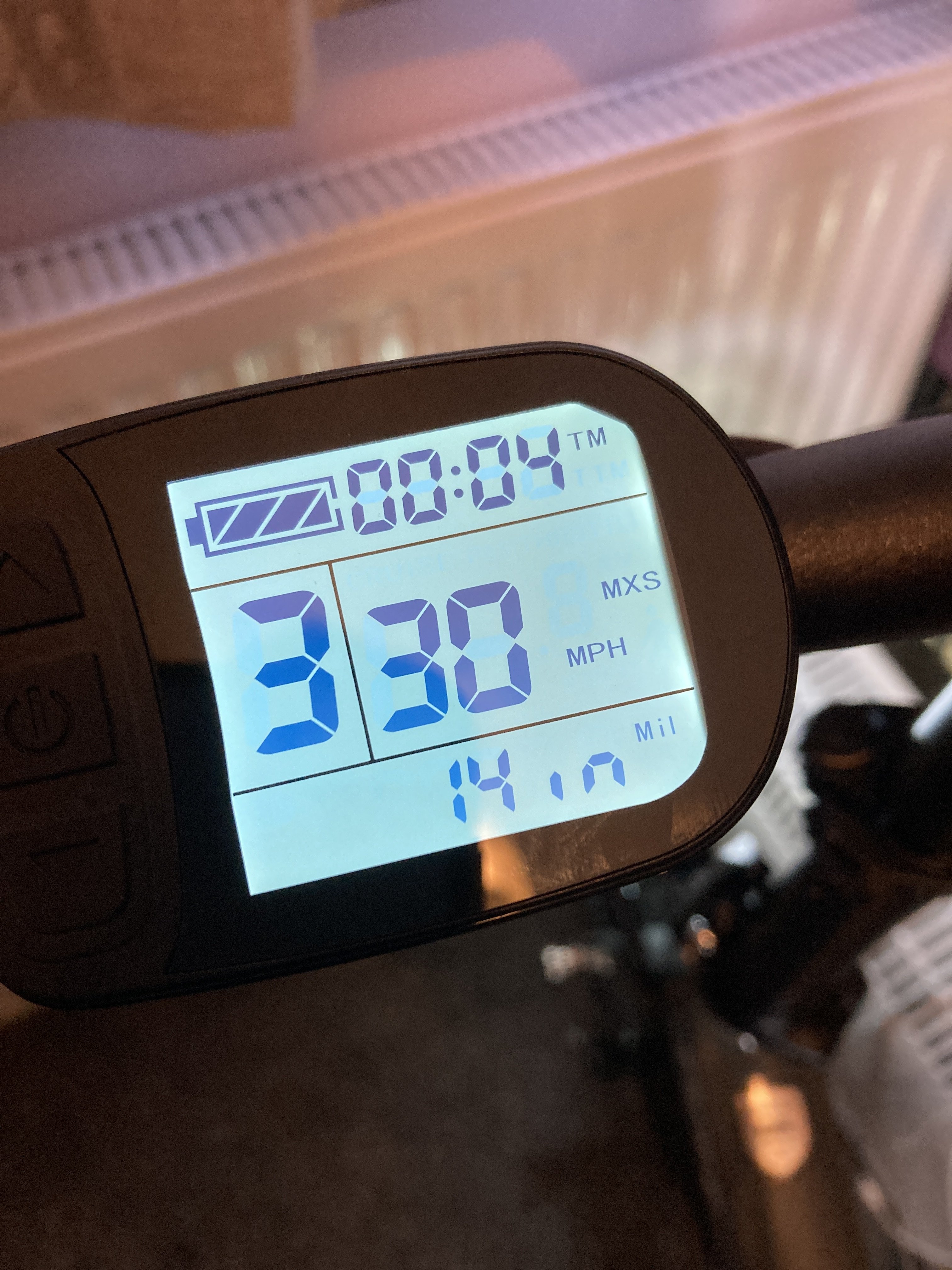

April 8, 20224 yr l've found out how to change the wheel circumference on my Mirider 1. l was messing with the controller and l held down the "boost" button while turning on the power. The display then showed "OPTIONS 1" Nothing else happened so l turned off the power. l then discovered (and l don't know if the above had anything to do with it) that if you turned on the power, then IMMEDIATELY held down the up/down buttons, the display backlight came on and it showed as on the picture below Using the buttons you can change the bottom number, which is the wheel circumference. Changing the "MXS" number made no difference. Also you can set miles or km Changing the wheel circumference to 14" (from 16") has increased the assist speed by just under 3mph, so the bike is now doing 18mph according to my GPS when the speedometer shows 16.5 where before it was doing around 15.5mph Whether you think this is worthwhile is up to you. lt does make the bike better to ride on the road, l guess you could change the circumference to 12" or even 8" (it will select those on the display) but it would be pointless as you can't really pedal it much faster than 18mph Also the speedometer would be totally inaccurate. Edited April 8, 20224 yr by lightning
April 9, 20224 yr Author The wheels on the Mirider actually measure 15" The controller will only select 14, 16 or 18" so it comes from the manufacturer set to 16"which makes the speedometer read about 8% high. So if you set it to 14" it reads around 8% low instead and the bike will go a bit faster. A 15" setting would be perfect, but there isn't one. Many owners won't care, but the extra 2-3 mph does make it better for road riding. On anything except slight hills it doesn't really matter as you can't get to 15mph anyway because the 250w motor isn't powerful enough.
