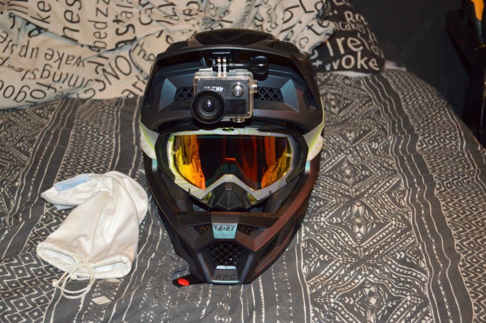

Very nice, but not a motorbike helmet.

If you're after a lightweight one, then go for polycarbonate (=cheap, but OK for low speeds) or carbon fibre (as per soundwave's suggestion but a motorbike-specific one (=expensive and usually full face).
Check the SHARP score before buying, to check the one you pick is reasonably good:
https://sharp.dft.gov.uk/
SHARP isn't perfect, but it's better than guessing.
Try searching for 'dirt bike helmet' or 'motocross helmet' for one with maximum airflow (if you're going to pedal and generate a bit of sweat). That will get you something similar to Soundwave's suggestion.
