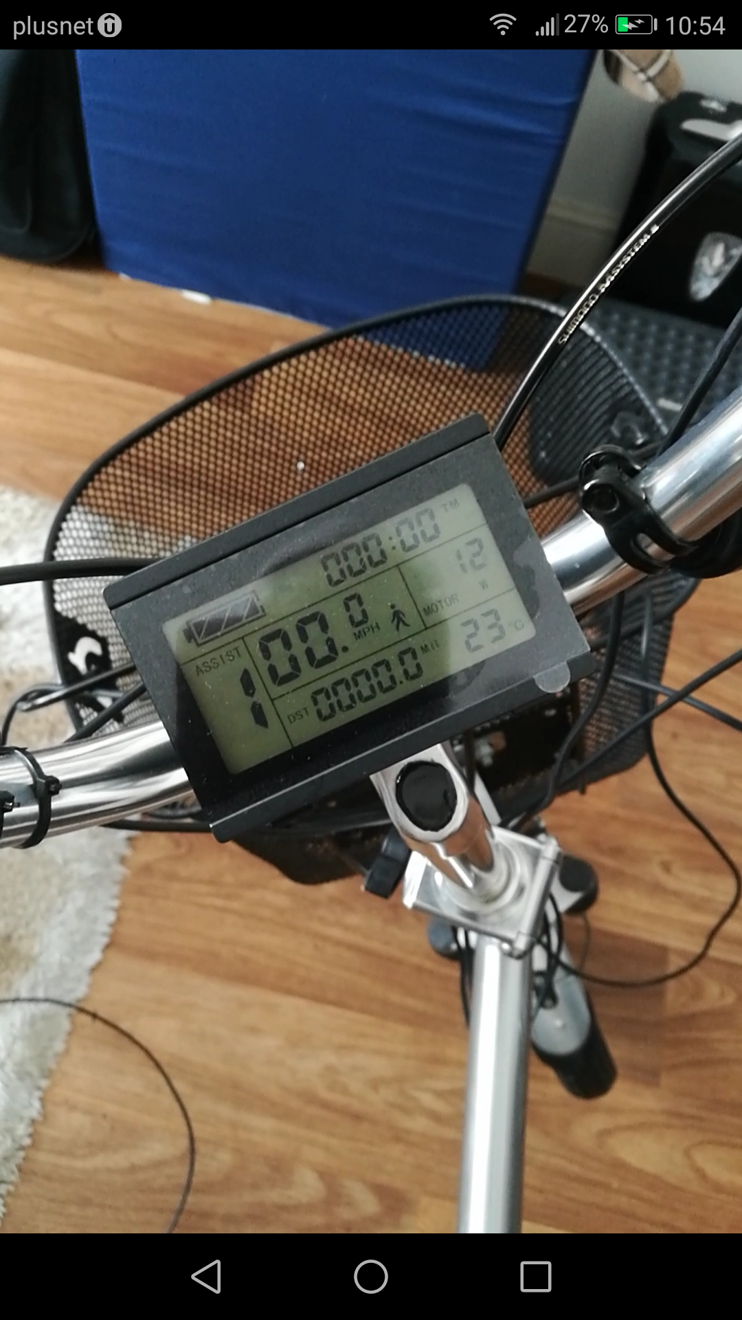

August 12, 20232 yr Author can you remind me what it's fault is? I keep getting 03 error code. The few times I've not had the code the motor wouldn't spin the wheel, I only got a slight judder and an output reading from the motor on the display. Pic attached. I connected my old controller yesterday and the wheel spins, so the halls should be ok, right? However, it's not safe to ride as throttle jams due to blown hall effect sensor or something inside the controller. Edited August 12, 20232 yr by UrbanPuma
August 12, 20232 yr I keep getting 03 error code. The few times I've not had the code the motor wouldn't spin the wheel, I only got a slight judder and an output reading from the motor on the display. Pic attached. I connected my old controller yesterday and the wheel spins, so the halls should be ok, right? However, it's not safe to ride as throttle jams due to blown hall effect sensor or something inside the controller. Throttle jamming is a throttle problem, nothing to do with the controller, except if you have cruise control enabled, which isprobably what you had. If one controller works and the other doesn't, it means E03 is wrong connection sequence unless the controller that works is for sensorless motors.
August 12, 20232 yr Author Throttle jamming is a throttle problem, nothing to do with the controller, except if you have cruise control enabled, which isprobably what you had. If one controller works and the other doesn't, it means E03 is wrong connection sequence unless the controller that works is for sensorless motors. Hi Saneagle, sorry my wording may have been wrong, the throttle was changing sound not jamming - it was tested and was normal. I think it's definitely a controller issue as two controller lights A & C did not come on at all on the ebike tester. I didn't have cruise control. A while back someone mentioned it might be a blown resistor or transistor in the controller causing the throttle to make a high pitched sound. It's a sensored controller, so I think you're right about the connection sequence being incorrect - just have to find someone to do it, so fingers crossed. Thanks very much for your help and speedy responses. Hopefully, I'll have it sorted soon.
August 12, 20232 yr Hi Saneagle, sorry my wording may have been wrong, the throttle was changing sound not jamming - it was tested and was normal. I think it's definitely a controller issue as two controller lights A & C did not come on at all on the ebike tester. I didn't have cruise control. A while back someone mentioned it might be a blown resistor or transistor in the controller causing the throttle to make a high pitched sound. It's a sensored controller, so I think you're right about the connection sequence being incorrect - just have to find someone to do it, so fingers crossed. Thanks very much for your help and speedy responses. Hopefully, I'll have it sorted soon. If I had your bike in front of me, it would be sorted in 5 minutes. Unfortunately, I'm at least 150 miles away and I just can't understand anything you're telling me. Maybe I'm just thick or too much senile dementure.
August 12, 20232 yr Author If I had your bike in front of me, it would be sorted in 5 minutes. Unfortunately, I'm at least 150 miles away and I just can't understand anything you're telling me. Maybe I'm just thick or too much senile dementure. It's definitely a connection/sequence issue. I'm sure you could have it fixed in a minute, but way too far away. Thanks for your time anyway.
