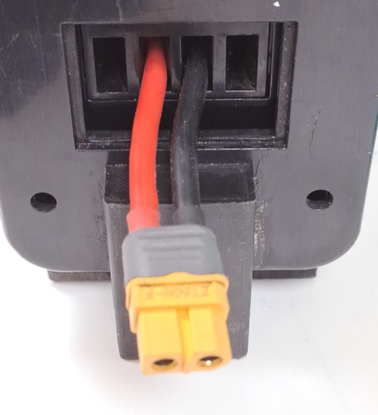

What sort of Yose Power pack do you have? For my Silverfish 15.6A I replaced the blade receptacle with 12 AWG cables and an XT60. From that it's quite easy to add a "Y" spitter or other power take off.
