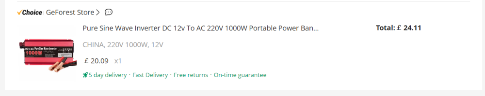

To power a beer fridge, various lights, water pump, hifi, cooling fan, foot massager, heated chair cover, and electric blanket in my remote garden shed using my ebike battery... Are there IP68 waterproof connectors suitable for ebike use? I could make Anderson Powerpoles, XT90 or similar rainproof using dielectric silicone grease and heat shrink, but having experienced one nasty submersion incident so far (went round a bend in a rainstorm, splashed into a pond sized puddle for 13 seconds, and had to bow wave my way out on PAS [thank goodness for PAS]), I'd prefer submersion safe connectors. If I do find suitable connectors, the plan would be to unplug the battery from the controller to prevent possible problems, and plug in the shed amenities via the "pure sine wave" inverter I bought in the ongoing AliExpress sale.

This isn't an urgent question, because I've ordered what looks like an identical battery mount to the one on my bike, for the shed.
To power a beer fridge, various lights, water pump, hifi, cooling fan, foot massager, and electric blanket in my remote garden shed using my ebike battery... Are there IP68 waterproof connectors suitable for ebike use? I could make Anderson Powerpoles, XT90 or similar rainproof using dielectric silicone grease and heat shrink, but having experienced one nasty submersion incident so far (went round a bend in a rainstorm, splashed into a pond sized puddle for 13 seconds, and had to bow wave my way out on PAS [thank goodness for PAS]), I'd prefer submersion safe connectors. If I do find suitable connectors, the plan would be to unplug the battery from the controller to prevent possible problems, and plug in the shed amenities via the "pure sine wave" inverter I bought in the ongoing AliExpress sale.
[ATTACH type=full" alt="55703]55703[/ATTACH]
