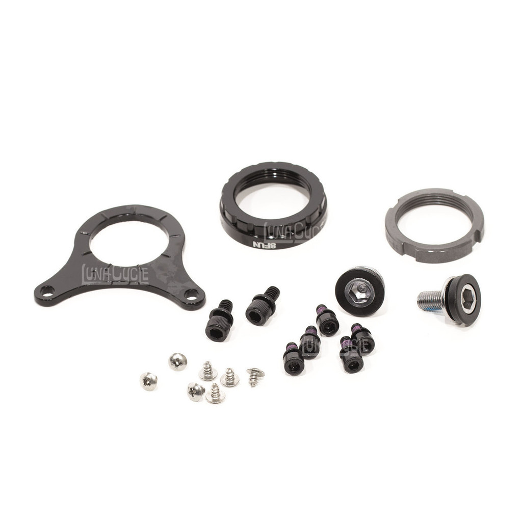

Hello Humberto. I hope you get great service and pleasure from riding your Bafang conversion. I have a BBS01 bike. The only problem I ever had was from the cranks starting to make a creaking sound. It was just that the large nut which pulls the Bafang unit hard into the frame had worked a little bit loose. I just tightened it up again HARD and it went away and has not come back since.

I fell this too, do you mean this nut right? The big silver one? I think i should buy a rubber hammer, to fix it into the frame.

Yes - the big one on the right that is made of steel.
I am ashamed to tell you, that I used a blunt cold chisel on the slot and a big hammer to move it another quarter turn to make it tight. I had a 'C' spanner which tightened it most of the way, then I put the blunt chisel into a slot and hammered it another quarter turn. You can get a proper tool for tightening it, but being a fundamentally bad engineer (not an engineer at all) I used the dirty method.
As I am sure you know, the outer threaded rig is aluminium and is just a locking ring.
