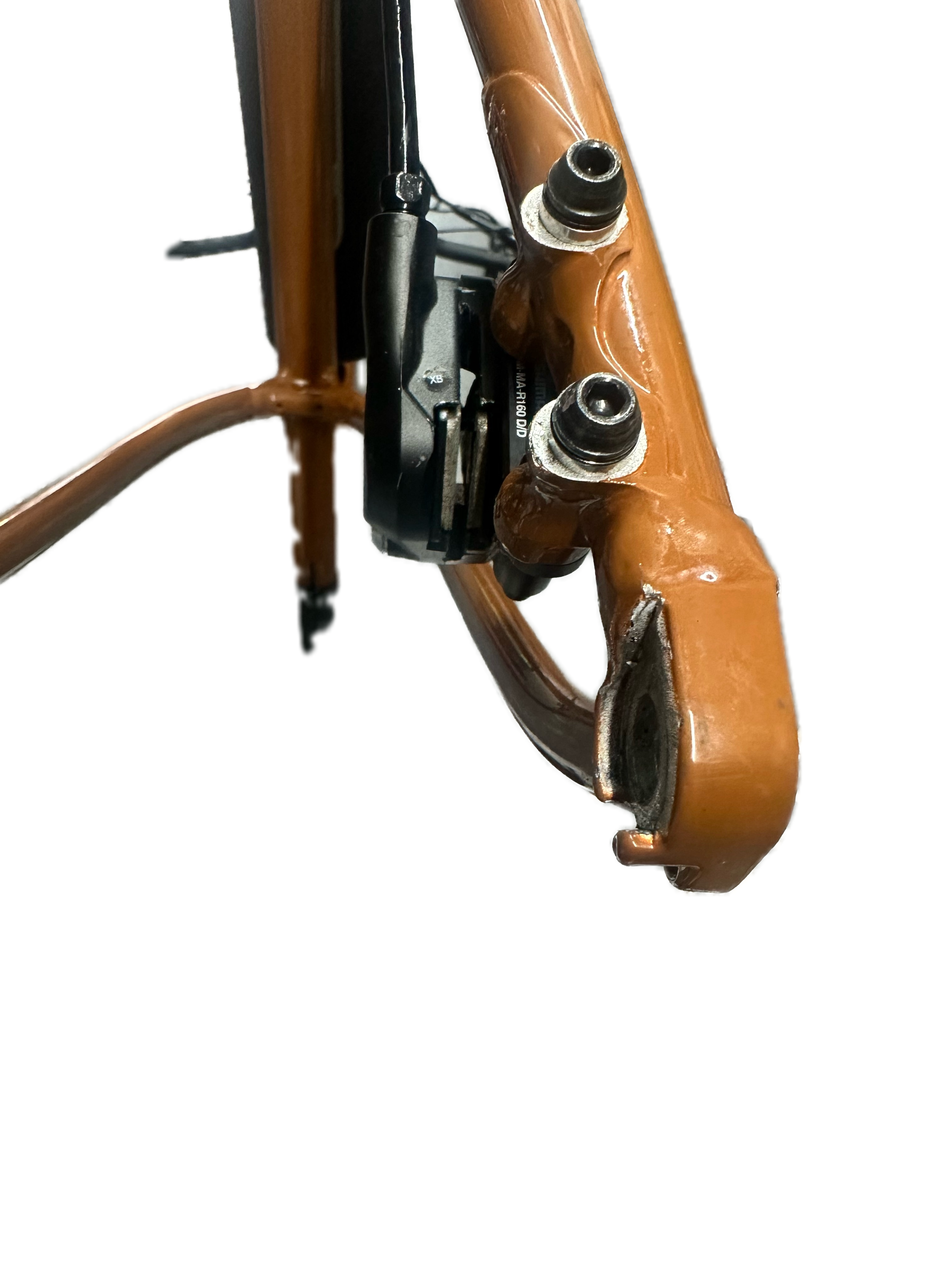

My thru axle frame has this little nub on either side where the thru axle motor fits. I think most thru axle frames will have this. Photos attached of my actual frame.
The motor fits in such a way in the dropouts that the cable has to point down (like you would a normal hub motor to avoid water ingress). The motor has a semi circular fitting that slots into the drop out and rests on this small nub.

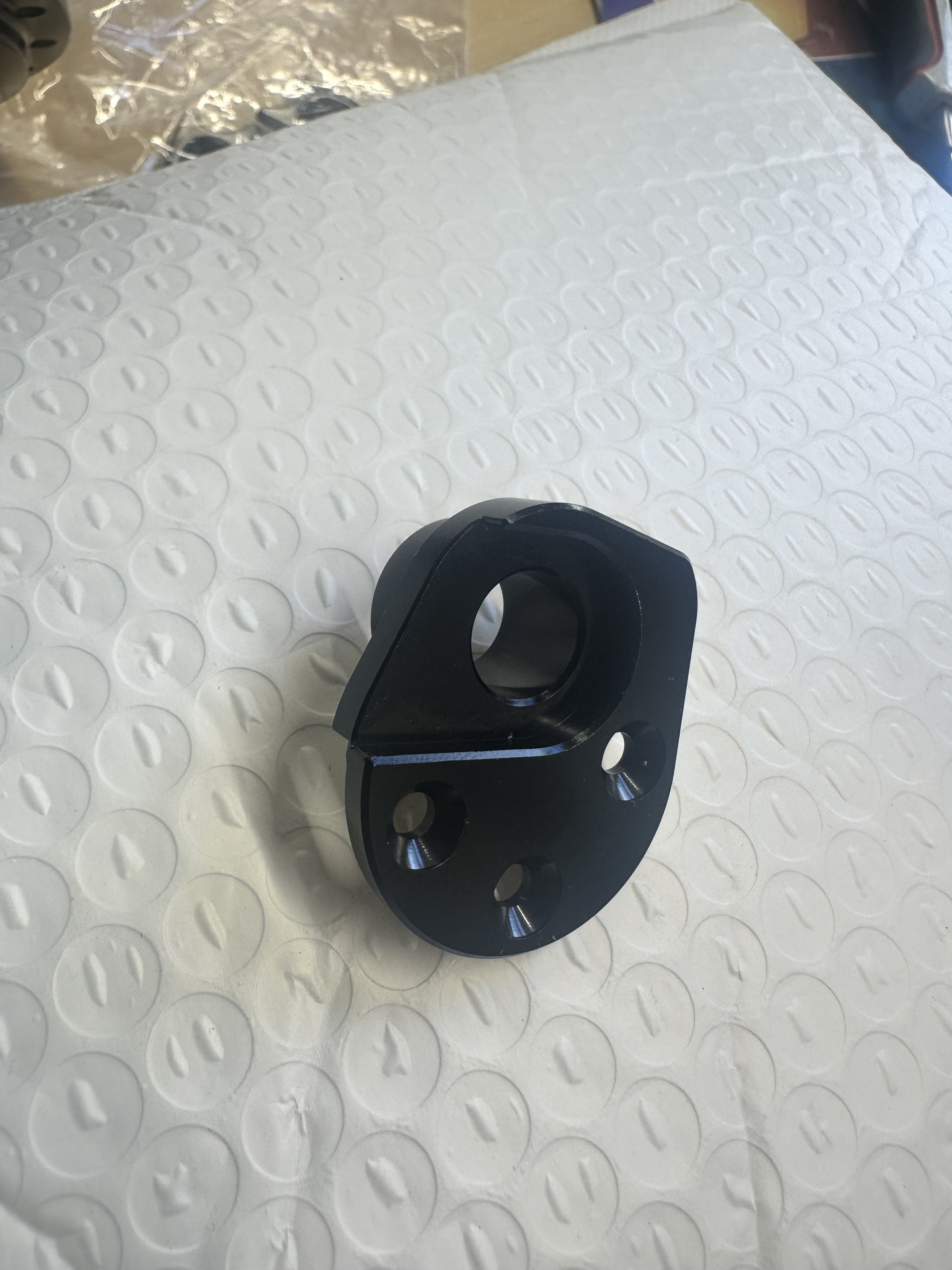

The Grin one comes with an attached torque arm.

Unfortunately on my Cannondale Topstone it has a little bit of aluminium and then a blank and then some more aluminium for the thru axle to sit in. See the photos. It’s hard to make out but I think the rest of the thru axle slot does offer some support to the thru axle motor. It’s not a tight fit though. Once the thru axle is tightened the motor does not move. In my opinion a more powerful motor with more torque may spin like it would in a normal dropout frame or break the little bit of aluminium that holds it in place.
I don’t think all thru axle frames are like this. For example a replaceable dropout from my mountain bike has a full recess for the thru axle to sit in. This is a lot beefier and will support the thru axle better. Again it’s not a tight fit. See the picture
As mentioned in another post it’s only the left side that offers any support to the thru axle motor. The right side is just round.
Picture also showing how the cable exits the frame. It’s not totally towards the bottom.

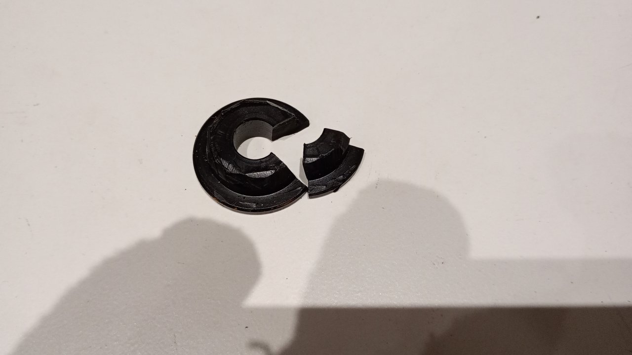

I also have a Boost Bikes thru axle motor. Now that has D shaped axles on both ends. The motor also comes with torque washers that take the shape of the thru axle slot on the frame. This gives support to both sides. This is not a normal thru axle motor hence the D shaped axles. The D shaped axles have a smaller hole so you have a QR skewer that holds it in place instead of a long thick bolt like in normal thru axles.
