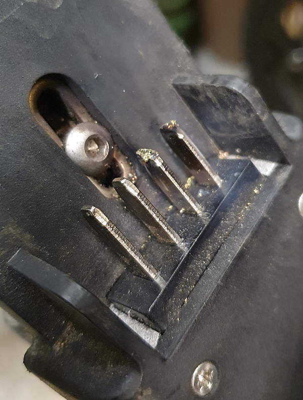

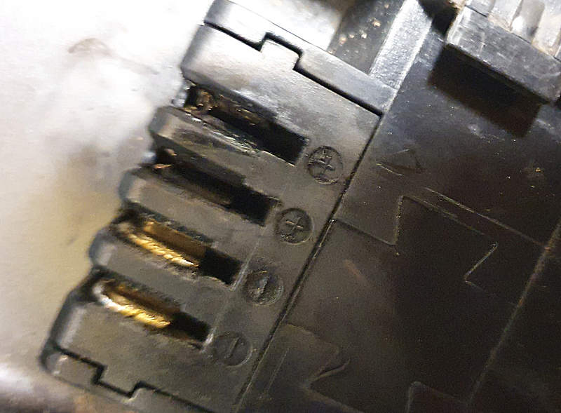

When I reinserted it into the bike battery holder there was a big flash and a smell of burning! So I took it out immediately and looked at the terminals. On the battery pack the two positive springs appear charred and the two positive spikes on the battery park holder have actually partly melted!

So I currently have a paperweight of a heavy bike with a motor but no power or battery, and a battery that looks like it won't even fit into the holder as the prongs have melted.
Admittedly the battery is five years old, but I have not used the bike as often as I expected to and would have thought there was still a reasonable amount of life left in the battery cells. Is it possible to replace the prongs on both battery and holder terminals? Or do I need a new battery and holder (in which case I hope compatible ones are still available?) It's a 36V 17AH downtube for front wheel (XF07) motor.
