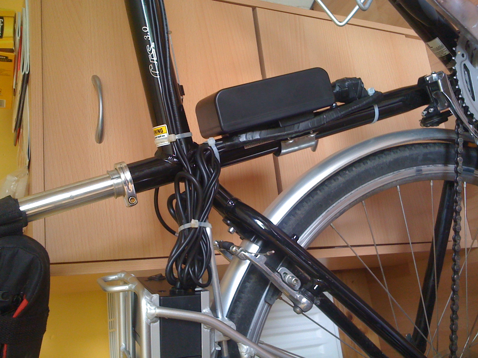

Yayy it's working a treat! I now have a USB socket near the front of the frame and the phone says it's charging when I plug it in!

36V. On the wire from the battery prong there was already junction branching off to the lights so I connected it there. I didn't add a switch so I guess there may be a few mA of loss when it's not in use.
I used a short USB extension cable, chopping off the plug. Helpfully it had red and black wires, though of course confirm they are the power wires by using a multimeter.
The wire is just long enough to run alongside the rear brake cable to put the socket under the frame at the front, where the charge cable for whatever device can be plugged in. It also has plastic cap to keep out water when not in use.
