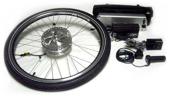

I agree with the Ezee kit advice. I fitted one to my fs mountian bike and it fitted 1st time and was very easy to do. The advantage is that the hub is powerful and quiet (after running in) and is disc brake compatible and relatively light (~3.5kg) and you can get different rpm versions up to 300rpm for a bit more speed.
Mounting a battery is the most difficult bit. I use a topeak RX rack.
My friend has a big powerful direct drive hub and it weighs about double, has resistance when pedalling without power and is V brake only.

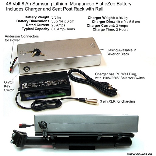

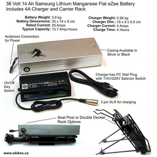

Ezee have alternative mounting battery options for kit bikes, a double decker rack, a seat post mounted rack and the rear rack mounting battery bag.
[ATTACH]1726.vB[/ATTACH][ATTACH]1725.vB[/ATTACH]

Actually Tony there are three 36v capacities available in the UK, 10Ah Li-pol, 14Ah Li-pol and 8.5Ah LiFePO4. There is also a 48v 8Ah battery which is not available in the UK yet.
[ATTACH]1729.vB[/ATTACH]
