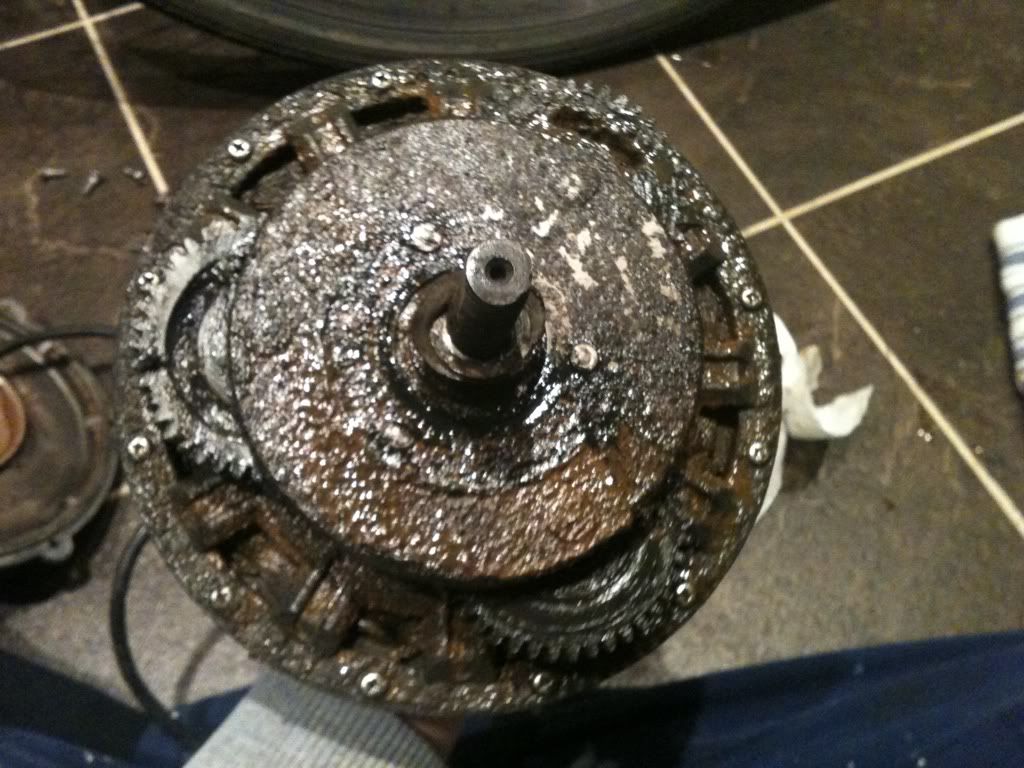

Noticed of later the weather, my commute and general aggressive riding style Is beating the crap out my bike. The poor thing needs a bit of an overhaul and some love. But in regards to this I've noticed a more metallic sound coming from my hub motor.
Also noticed a small wobble coming from the back wheel. Noticed when moving the wheel it was all the way round. Thought it's got to be a bearing. Couldn't be the gears or anything else. Axel is tight and running two torque arms now.
Long story short here's some pictures ...

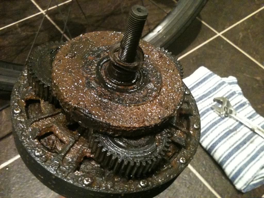

Nice watery goodness. Lovely water and grease mixed in. Surprised it ran with all the water in it. This shows how much was inside.

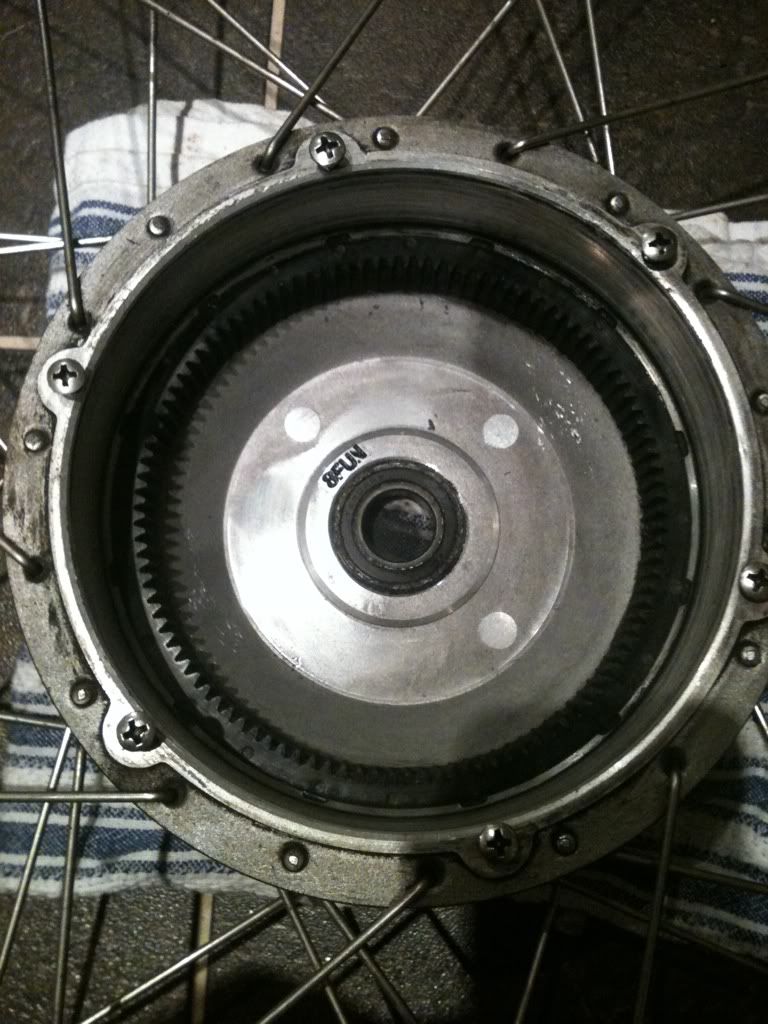

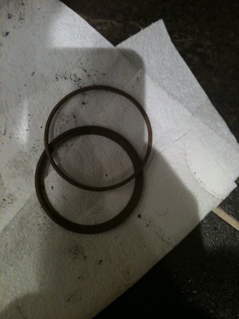

Bearing for reference.
And the unsealed bearing making the noise and play.
I'll have to wait till the weekend for a full clean up and re grease.
The bearing Is pretty knackered though. The sealed bearing is ok but might be worth me replacing it anyway.
The open bearing looks worse for wear.
If anyone knows where to buy spares I'm all ears. If not I'm sure I can find something locally. As the outer races are a little battered.
Surprised they didn't use a better bearing but then again I guess there usually better sealed. Part of having a cheaper hub.

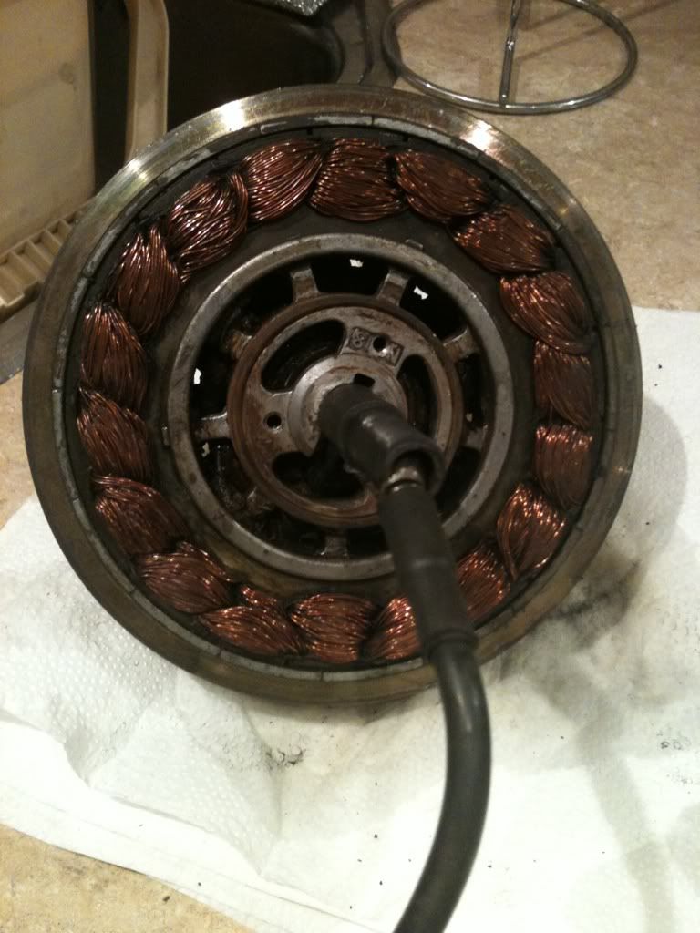

Gears and out ring look well and the windings are still a lovely copper colour once there cleaned. This is after 3000 miles at 44v 22amp.

wow, that is dirty ugly :eek:
I hope when I'll get my bafang it's now going to look like this. How come is it still running?

Wow what a mess, wheres the water getting in? I hope that bearing is not a bespoke one...do you have any local engineering shops you take it to...would be better than working your way through a parts catalogue. Just wondering if it will clean up OK especially the planet gears, their bearings and the clutch...maybe a new motor is in order and just swap over the internals?

I'm wondering if you have the cable with a loop downwards to stop the water entering the hub through gravity. Might be an idea to seal with silicone as well. I can't imagine it's getting in through the cover. Bearings are usually common standard size, any bearing supplier should have them on the shelf i would have thought. Gears still look in remarkable shape.
Ah i just made out the bearing you mean (looking through the gunge) i still think you may be able to replace the ball bearings or the whole thing.
Deleted member 4366
There were a couple like that on ES. Like Wurly says, the water runs down the cable and in through the axle. You must make sure that where the cable exits, it goes downwards. I added extra tape to mine just to make sure. You should be able to get the bearing at any local stockist.Just take the old one with you for them to measure. It's probably a standard size, or you can measure the width, ODand ID with a caliper gauge and phone it through, or get the numbers off it, which they'll usually recognise..
Your problem can happen to most hub-motors with a cable that exits the axle. The cable must go down before up to stop water running in - worse during the winter when the water has salt in it.

We've had a few reported in here with the same problem, as d8veh says, it's water entry via the cable due to inadequate sealing on some motors. It's worth adding more silicone sealant at the entry point on a new motor, and on the types with the small spindle bearings, sealing the external housing entry with some grease to deter water access to the bearings.

Yeah the cable is now got a rain loop. But the damage is already done to be honest. The bearing this morning was fully battered. So I am back to riding unassisted after today. Not really an issue just takes me longer.
To be honest I'm sure I can have a ride around some local engineering firms round Birmingham and get a bit of help on it. The motor itself works perfectly. I'm suprised it still runs so well.
But the bearing is shafted and because the grease inside is now watered down its no longer doing its job.
The bearing although supports my weight and rotates its a horrible sound and if I keep using it I'll only damage it more. Then there will be metal fragments rotating round that will cause more damage.
I cleaned it up last night but it really needs a soak and a bake to get it back to new and remove the unwated grease.
So a little help from you wonderful people. What will be the best thing for removing the grease?
Cleaning up the inners?
I'd like to fit a better bearing but believe the one that is shot uses a race that the ball bearings sit in with a couple of cups that sit on top to hold the bearings in. I believe they where meant to be all one piece but maybe with the extra speed / me and the occasional curb hopping i've broken the bearing open. I'm not sure.
