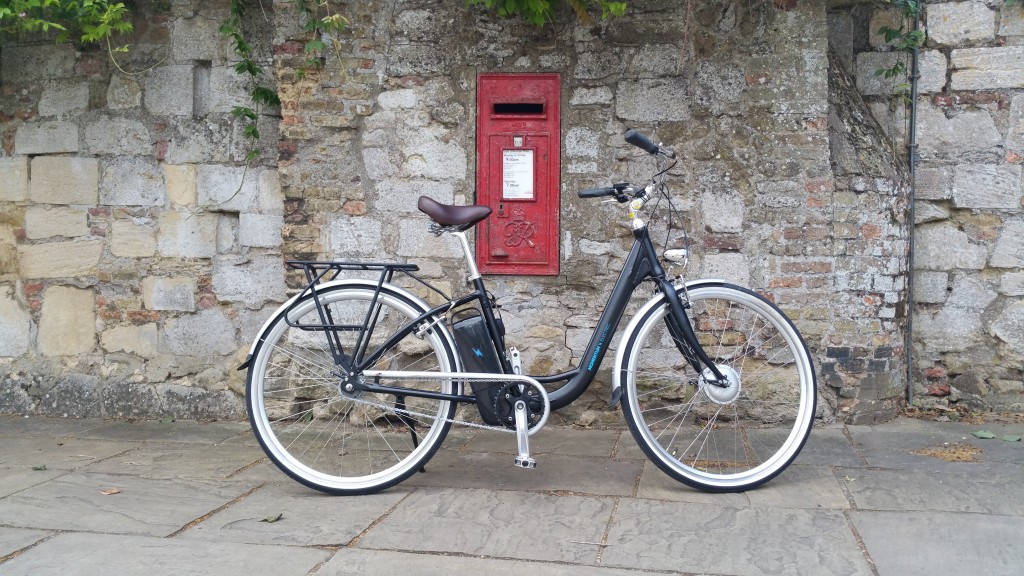

The Model T
While the Upstart is a diamond-framed urban roadster with no frills and built for speed, the Model T is aimed at a different market segment, those looking for a more laid back, leisurely style ride. Omitting the cross-bar of the Upstart, the Model T promotes comfort and practicality for all ages and abilities. It is available in two sizes and you can have any colour, so as long as it’s black!

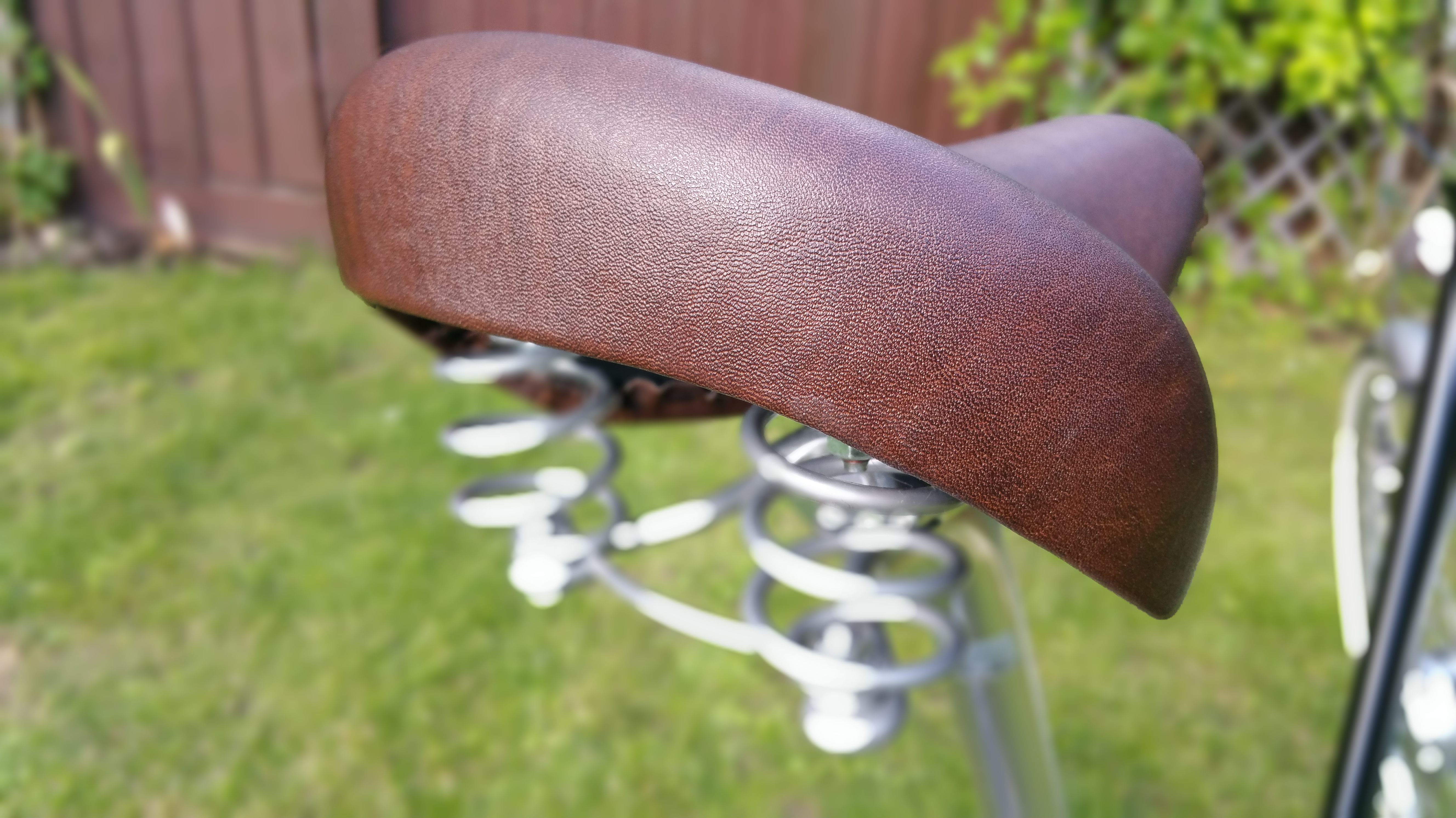

The design has a vintage Victorian, understated look with whitewall tyres, silver mudguards and chain guard. Momentum have also opted for a black rear rack which blends into the frame. Completing the retro look is a brown leather-effect sprung seat. The overall effect is attractive to the eye, with no lairy colours or decals, just simple and elegant.
momentum-model-t-sprung-saddle
At first glance, you would be forgiven for thinking that this is a single speed bike. However, Momentum Electric have incorporated an SRAM Automatix hub gear, its unique selling point being that it uses centrifugal force to change gear for you automatically based on your speed. There are two gears, the lower gear being direct drive and the second higher gear steps up to 136%.

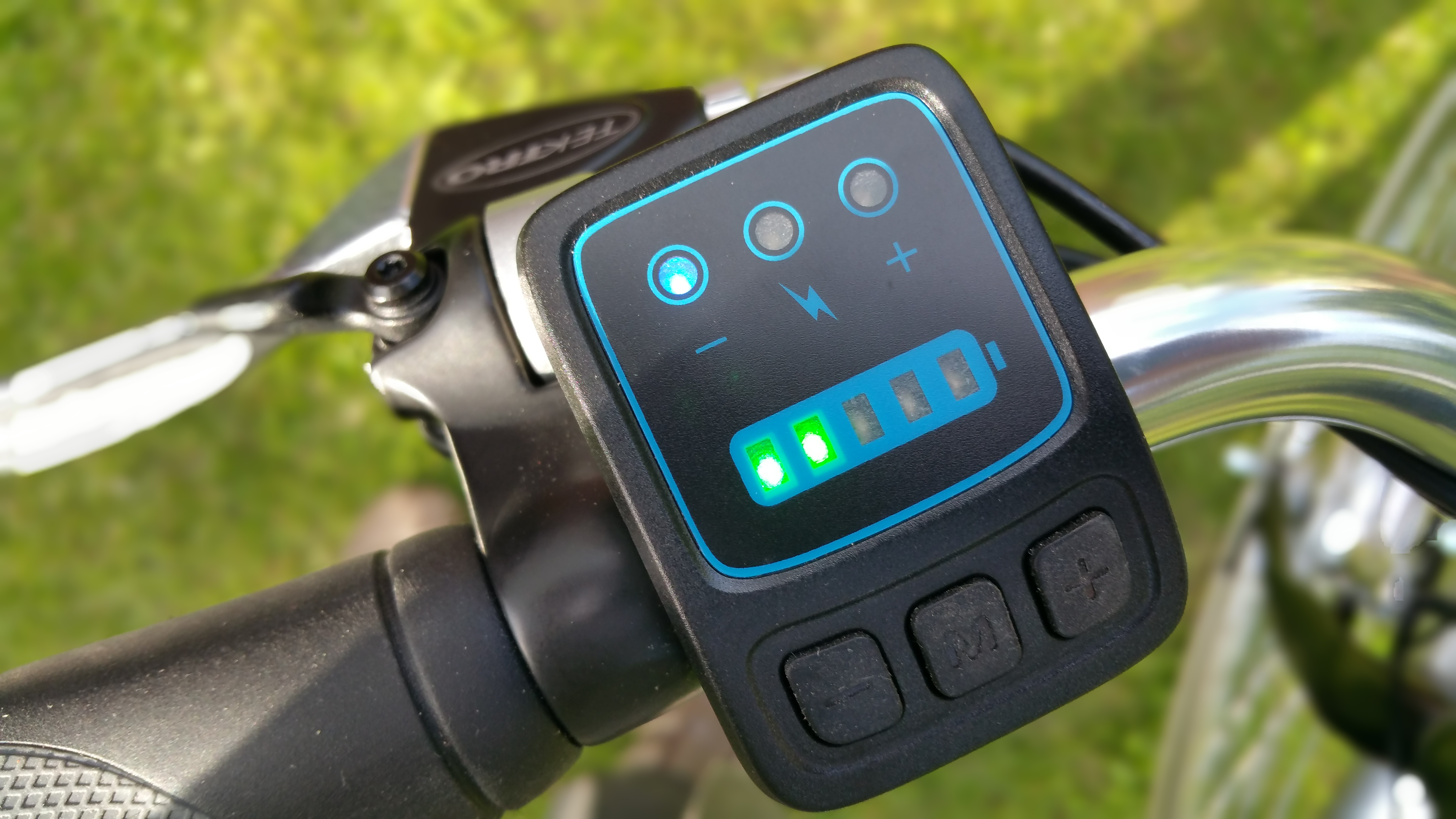

Stepping onto the bike, you’ll notice that situated next to the left-hand grip/above the brake lever is the bike’s control unit. It’s a simple affair with no fancy LCD display, just two rows of LEDs above 3 buttons, one set showing the currently selected assistance level, the other how much power you have left in your battery.
The middle button switches the bike on with the default assistance level set to 1 (the lowest level, bar off/no assistance). Plus and minus (+ -) buttons either side of the on/off button control the level of assistance the motor gives you, ranging simply from ‘low’, ‘medium’ and ‘high’.

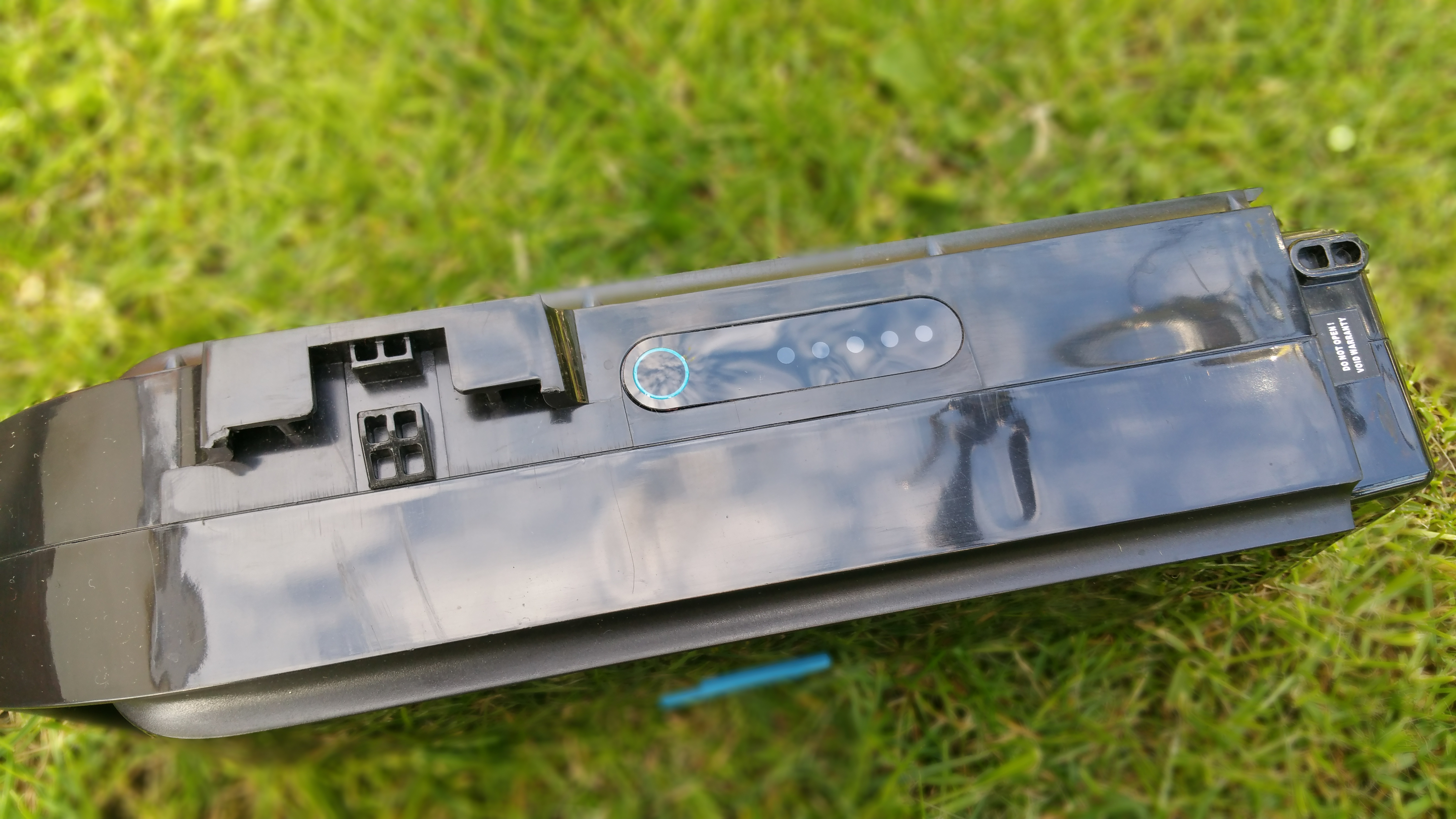

momentum-model-t-lithium-battery
After 7.2 miles of mainly flat roads, the first battery level light extinguished on the display. There are 5 lights in total on the display informing you of the remaining capacity of the battery. Skirting round Newmarket and down into Suffolk, the terrain started to get more hilly. Still on the B roads, the second battery level light went out at 13 miles.

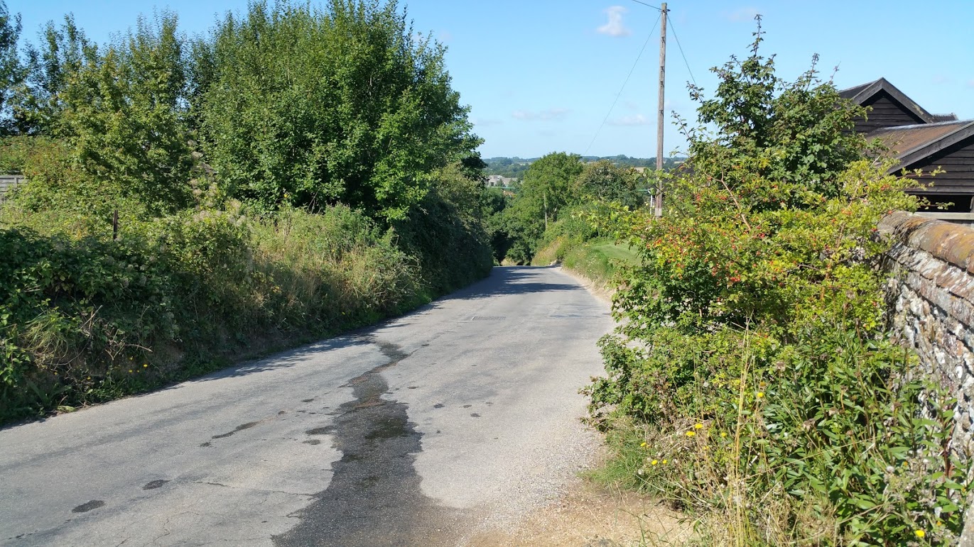

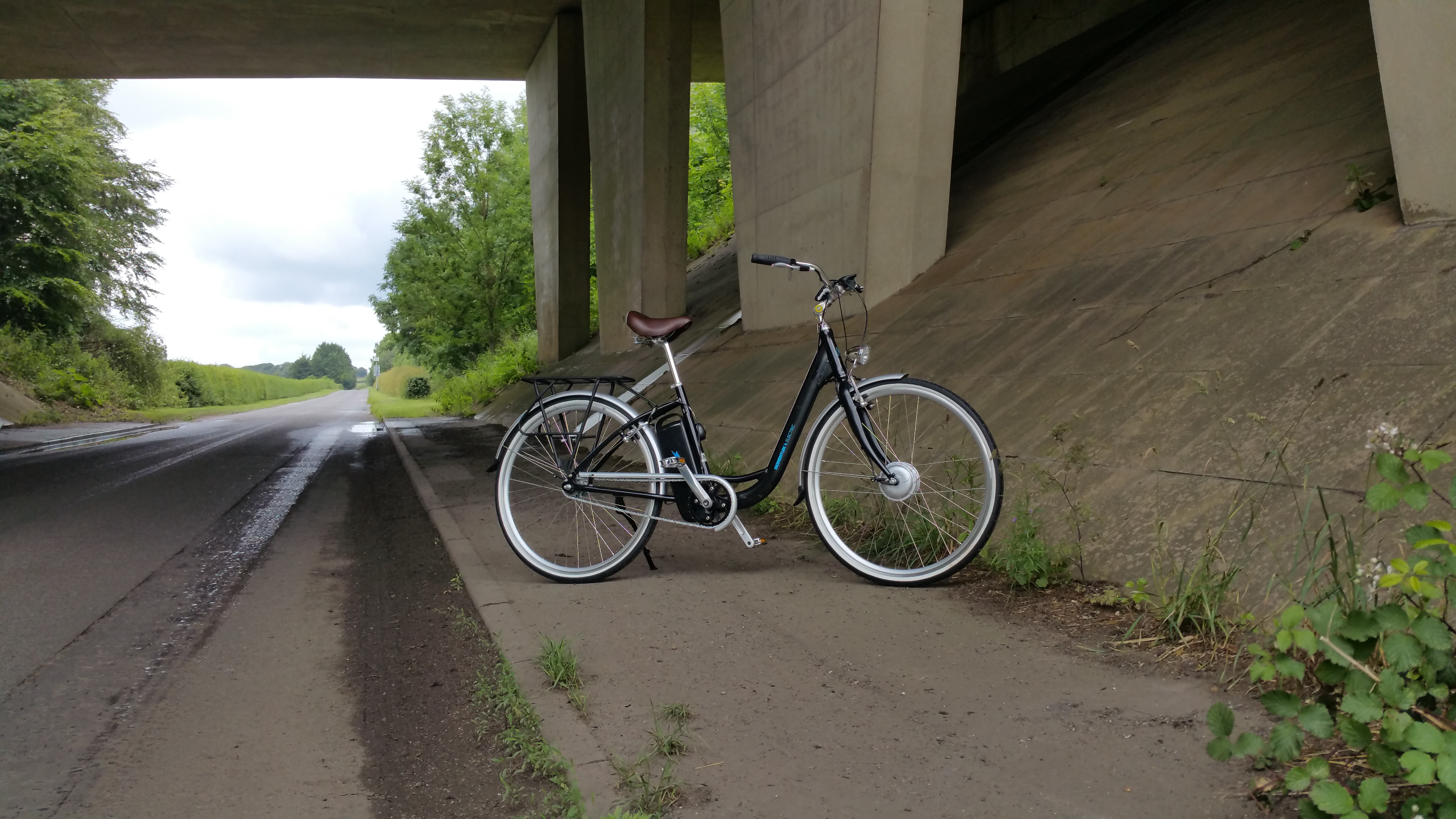

I took the Model T to Hartest hill in Suffolk – my usual haunt for testing electric bikes. Unfortunately, there are a lack of decent hills in East Anglia and this is probably one of the best, a quarter mile section with a 17% gradient at its steepest section. It’s used a lot by regular club riders testing their fitness and I often come across one or two zigzagging their way up the hill.
To test the Model T, I planned to do a few runs up and down the hill, first testing for the maximum speed, lowest speed and maximum assistance.
momentum-model-t-ely-review
The first test was to approach using maximum assistance, tackling the climb as fast as possible. Starting off from the bottom of the hill at 13 mph, I tried to maintain this speed going up the hill. During the climb the speed dropped to around 4 mph as the motor struggled on the steepest section. Thinking this would be a bum out of seat moment, I was pleasantly surprised that the motor managed to keep providing enough oomph to crawl to the top of the hill. So a good result there, certainly not the fastest bike I’ve tested on this hill, but it made it nonetheless.
One thing I noticed is if you’re in the higher gear and your speed drops it won’t automatically drop down into the lower gear. I needed to ease off momentarily on the pedals to get the bike to select the lower gear.

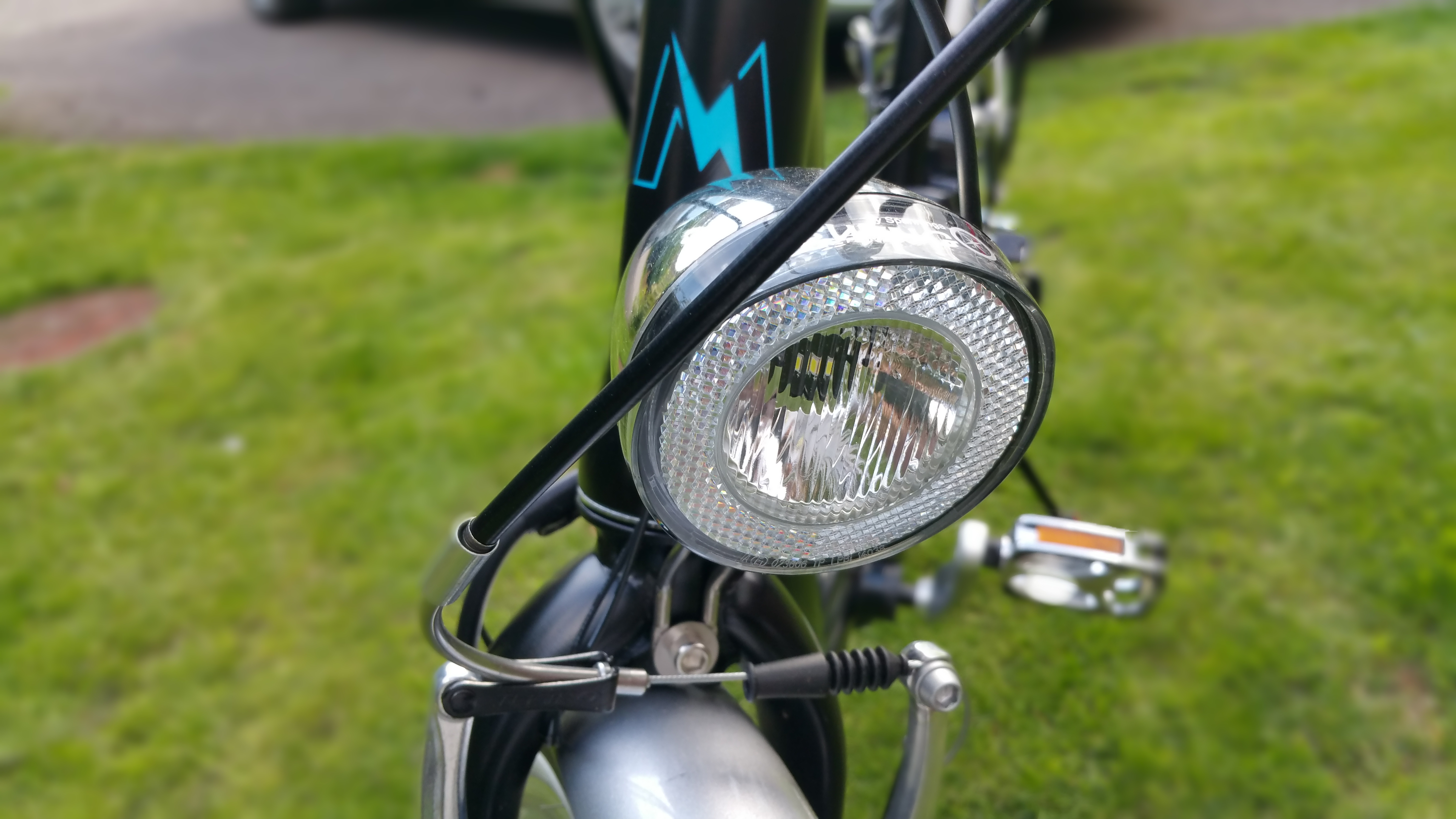

momentum-model-t-spanninga-front-led-light
Practicalities and security
To help combat the typical British weather, the Model T already comes fully equipped with proper silver painted mudguards front and rear, as well as a matching chain guard to help keep your clothes clean and dry. It also comes with a matching black rear rack already fitted, which is rated to 25 Kg. My Ortleib panniers fitted just fine with the rack being far enough back so you don’t catch your feet.
For night riding, there are Spanninga LED lights fitted front and rear and they both run off the bike’s Lithium battery, so you don’t need to worry about buying aftermarket lights and batteries. The lights are easily switched on and off using the the + (right) button and they both come on together. They’re adequate enough for urban use though. As with any other bike, you can always add your own if you need to.

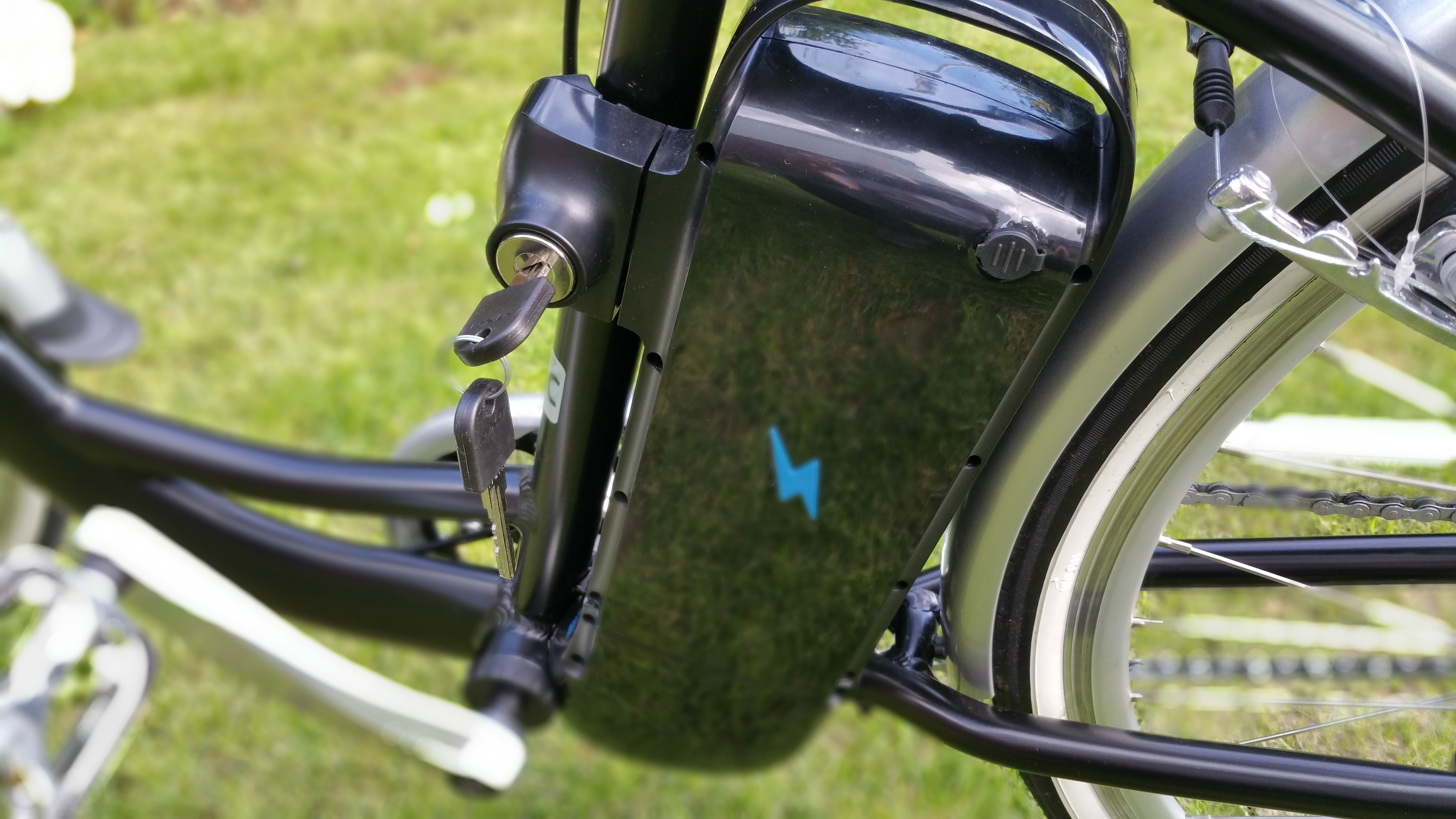

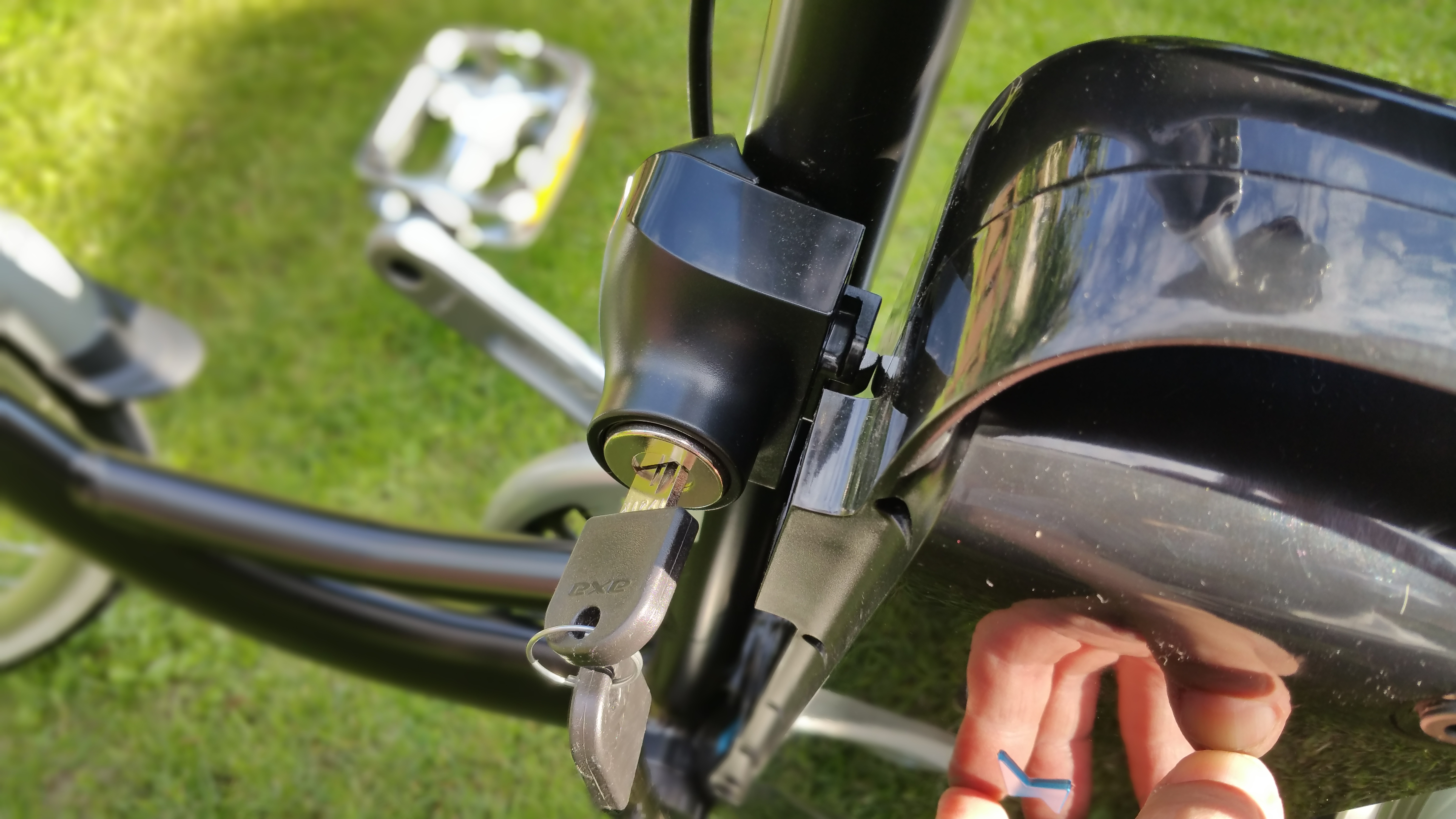

In terms of security, the battery is locked into position when fitted to the bike and you’ll need one of the two supplied keys in order to remove it. There’s a satisfying click as it locks into place and it feels sturdy with no wiggling around.

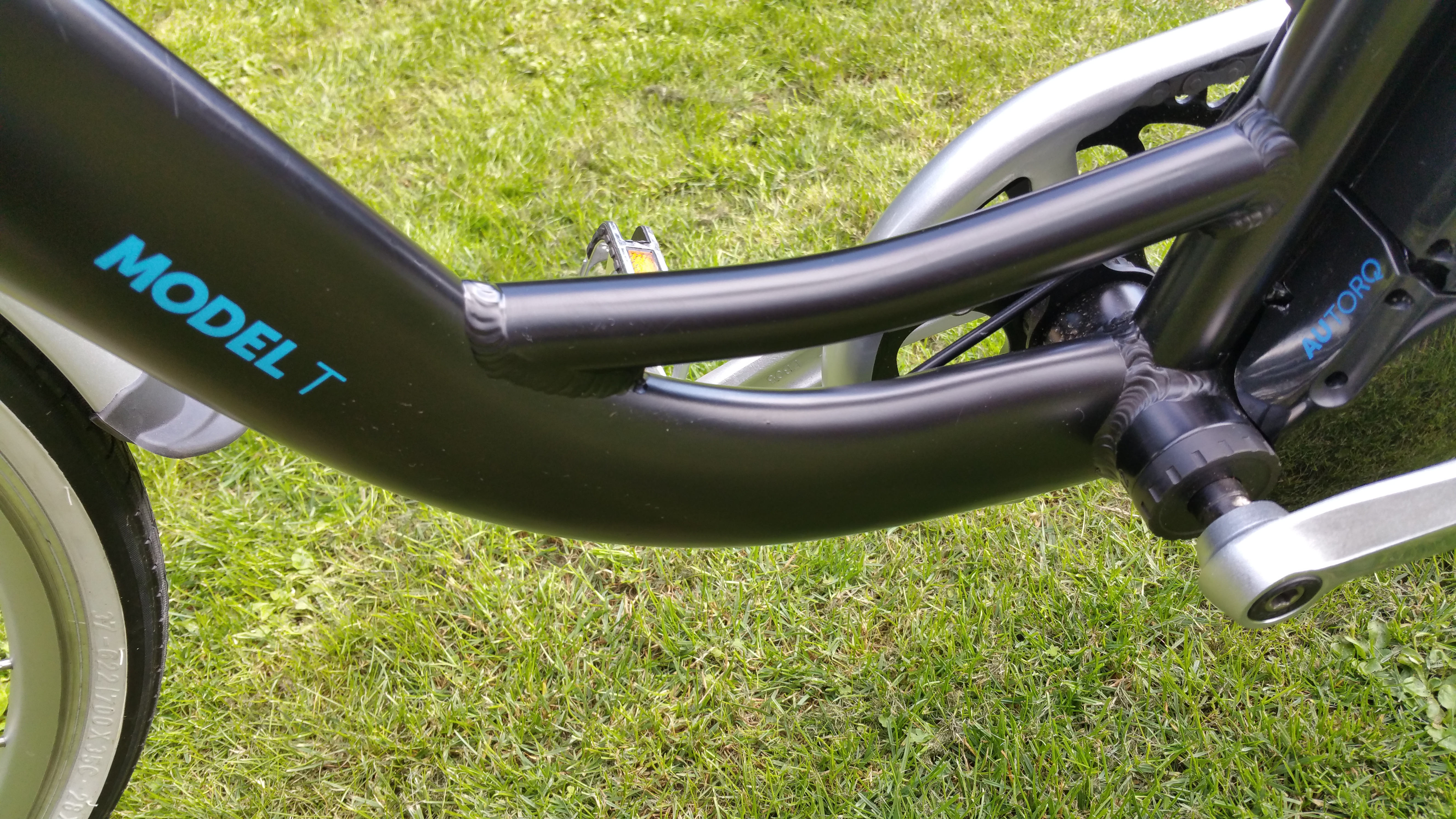

The revised Model T has the inclusion of a carry ‘handle’ in the bottom of the frame should you need to lug the bike up some steps for example. Thankfully, the bike isn’t too heavy at 19kg (excluding the battery). Oddly, it actually felt lighter than this! The bike also comes with a stand and there is also a walk assist function which can be operated using the – button on the control unit.

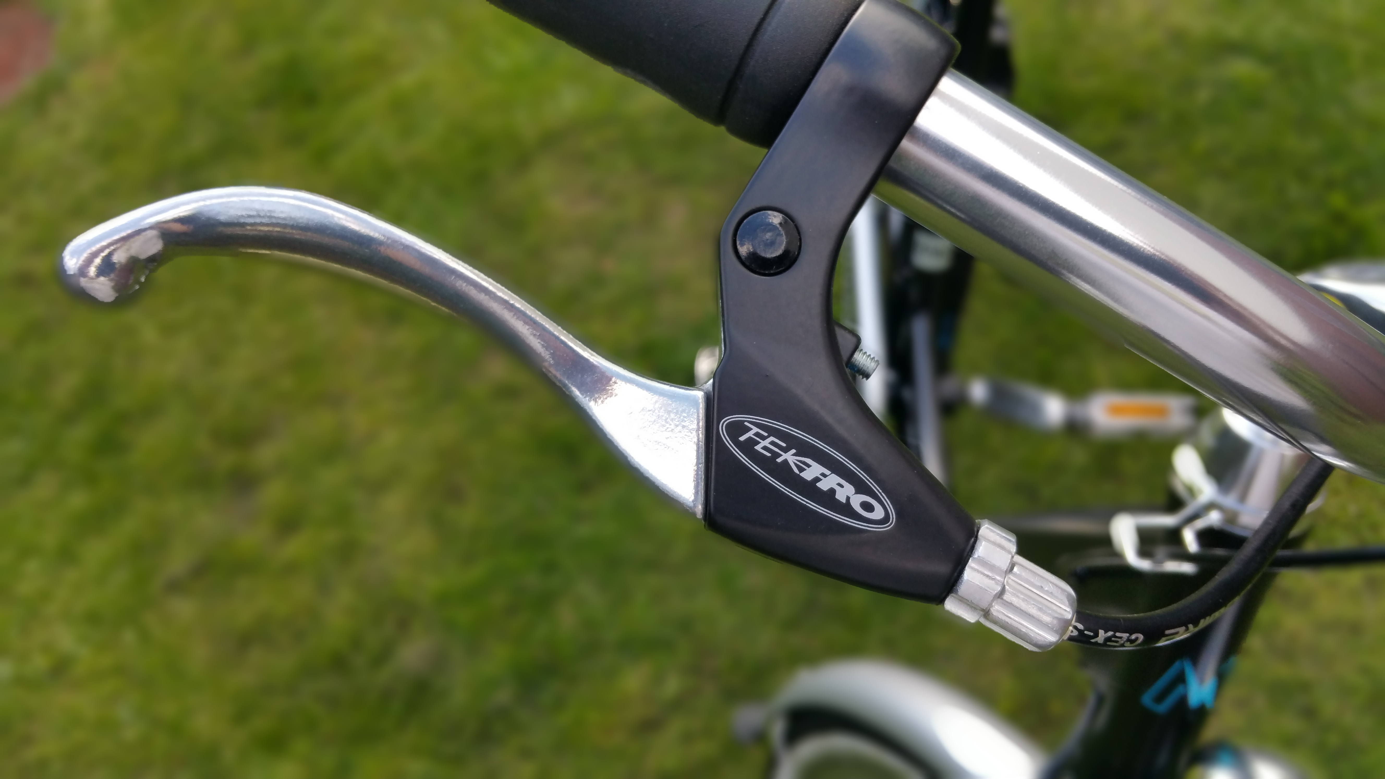

momentum-model-t-tektro-brakes

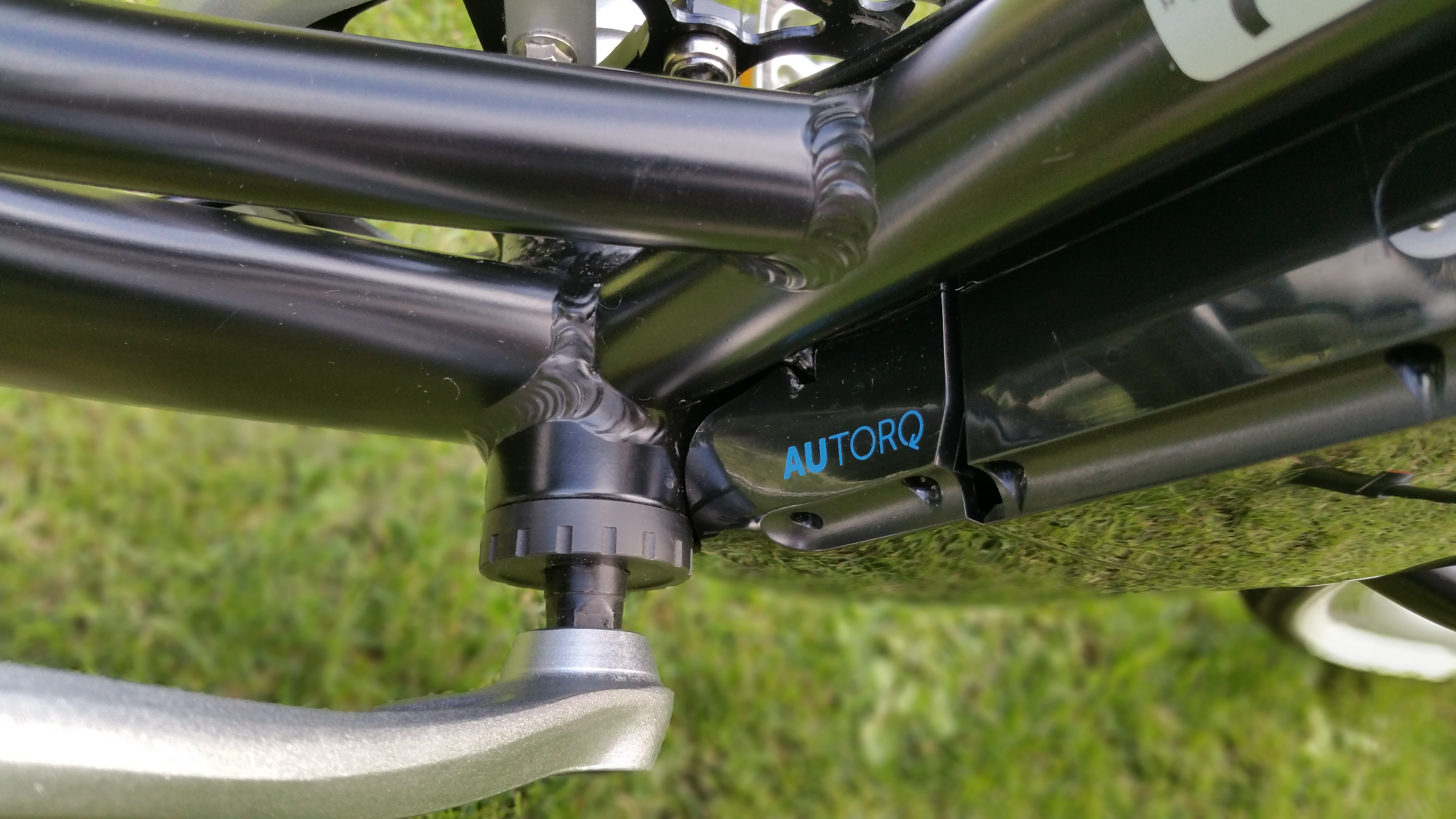

It’s good to see the brake cables have been routed through the frame for aesthetics. Also the controller/power cables from the bottom bracket are routed this way.
momentum-model-t-key-lock-for-battery

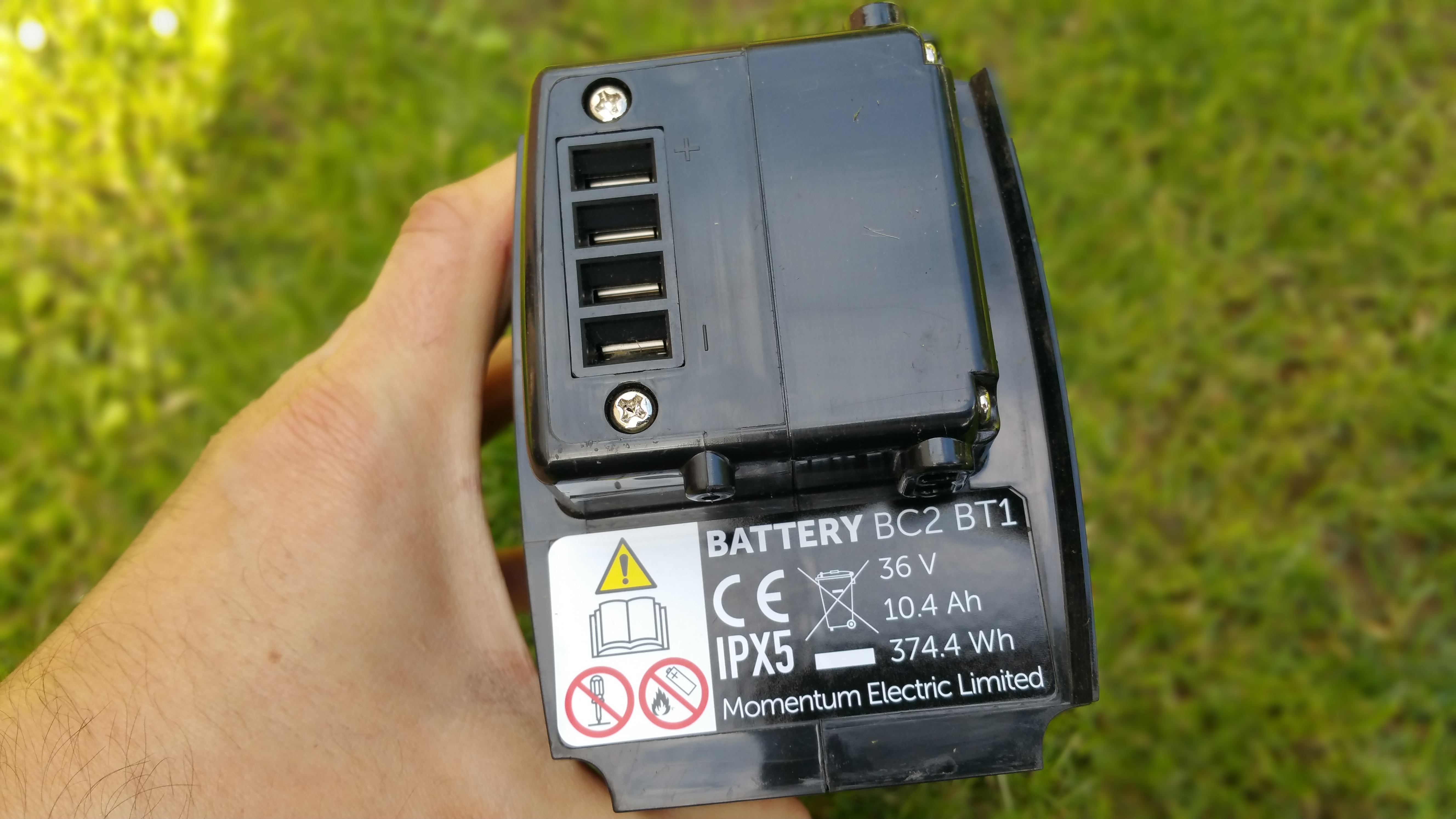

To fit the battery, you go in from the side and then once it connects with the base unit you push it until it clicks with the lock. While you need a key to remove the battery from the bike, you don’t need the keys to be in the lock to fit it back on, which is good. For removal ,the battery does have a carry handle at the top, but just be aware the base doesn’t sit flat on the ground due to the connector so it’s easy for it to topple over.

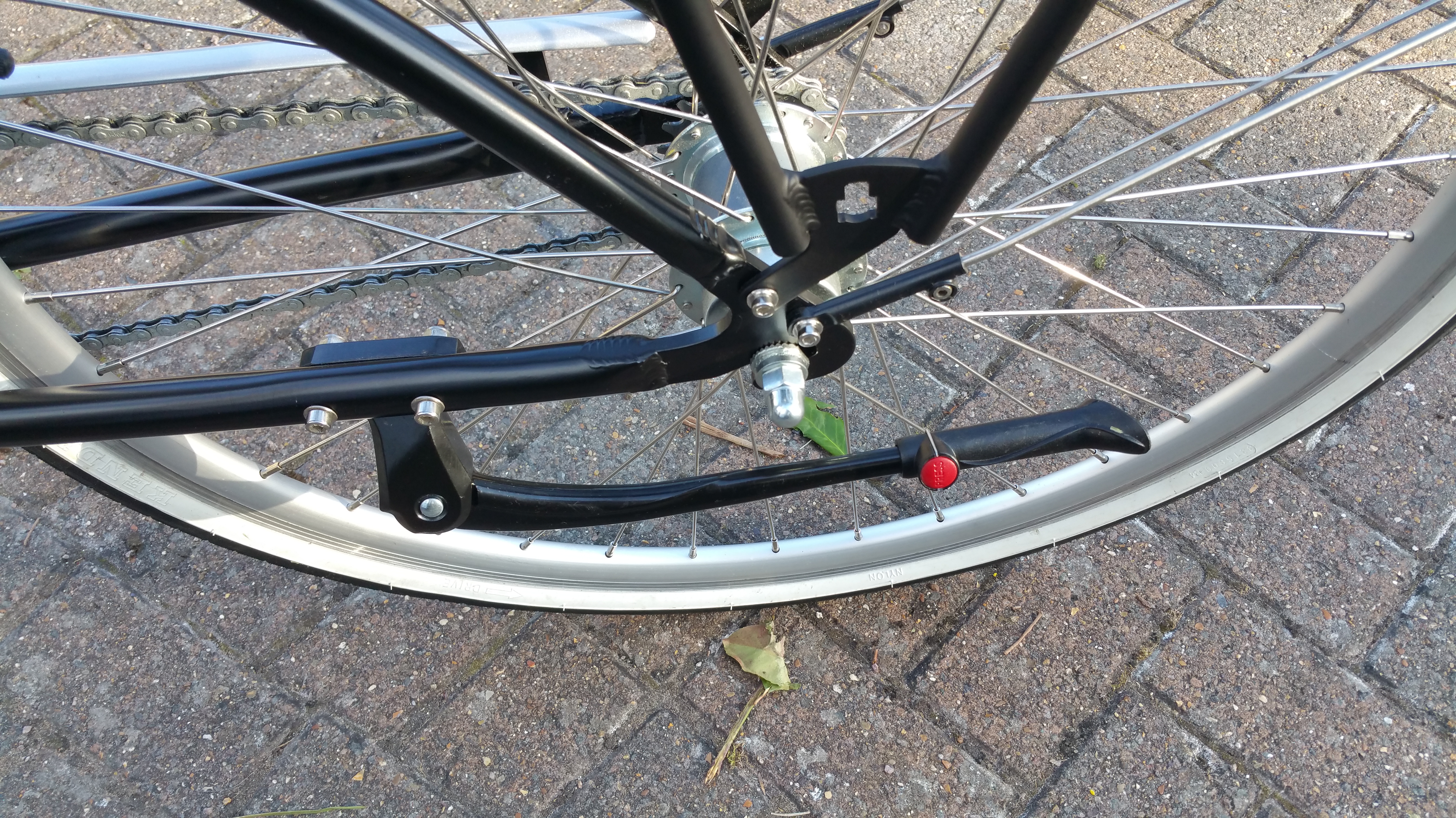

momentum-model-t-kick-stand

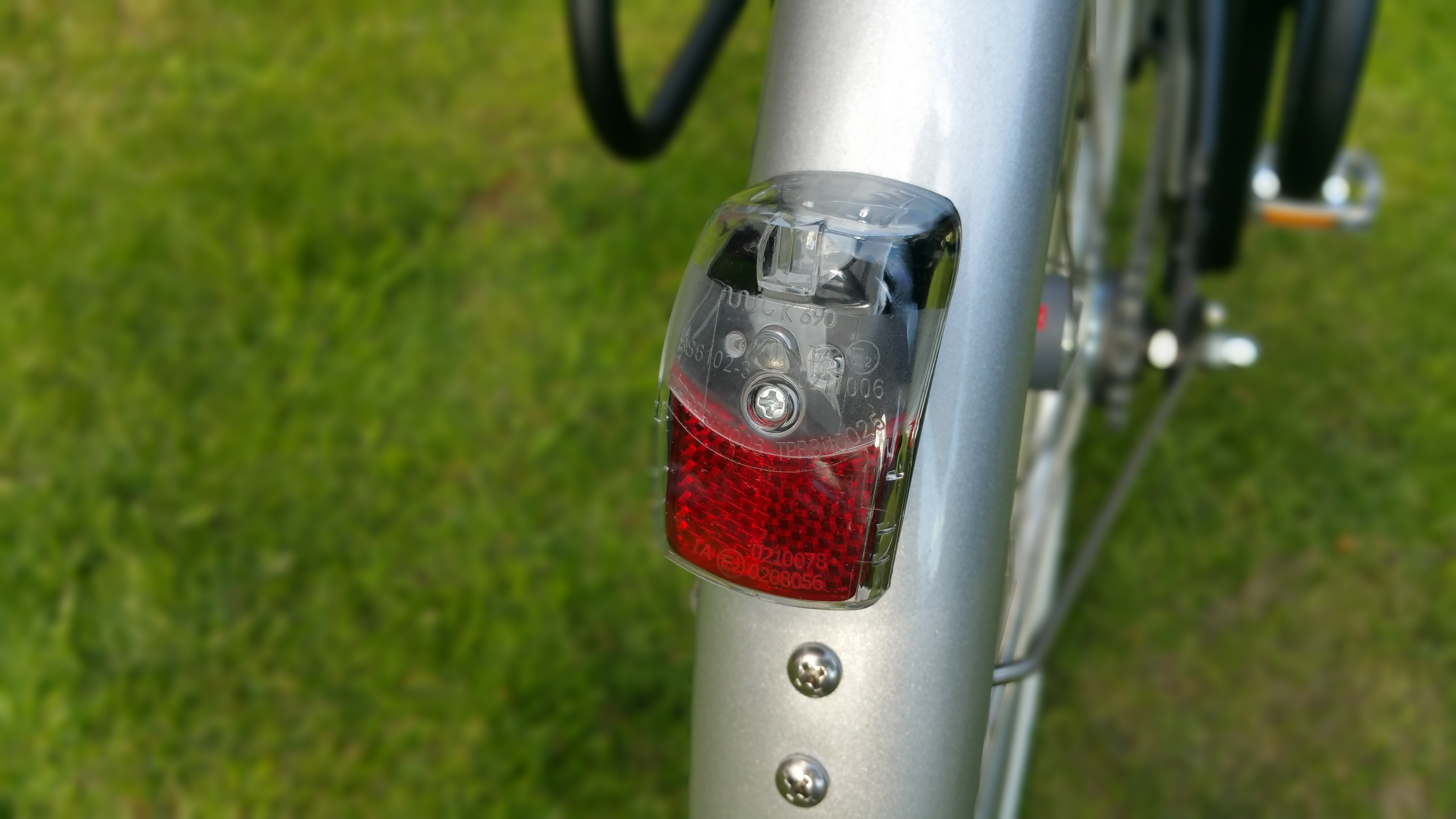

momentum-model-t-rear-led-light

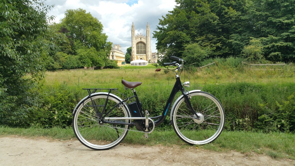

There’s a lot to like about the Model T, from the understated styling to the no-frills just get-on-and-go setup. A comfortable seat with a sit up and beg riding position, easy on and off with the step-through frame and quiet automatic gear changing. So with those credits rolling, if you want a no-nonsense bike to run errands, or for an urban commute there is little to criticise.
From my experience, it coped well on hills up to 15% or so, if you have any steeper challenges in your locality then definitely take the bike on a test ride up and down those to see how it fares for you. Bear in mind the Automatix won’t change a gear down while there is a load on the pedals, so you need to ease off.
It’s aimed at the urban cyclist, so this model is not built for performance (take a look at its sibling, the Upstart if you’re after a roadster) but it feels sturdy, well-made and there was no rattling.
At £1,350 there is a lot of competition, but the Model T puts up a big fight for those in the market for an easy to use e-bike around town. The price point includes a 5 year warranty on the frame, 2 years on the electrics. It’s good to see the battery is included in the 2 years too.As always, with any bike, we strongly recommend a test-ride before splurging your hard-earned cash. You can find links to dealers at the end of this review.
