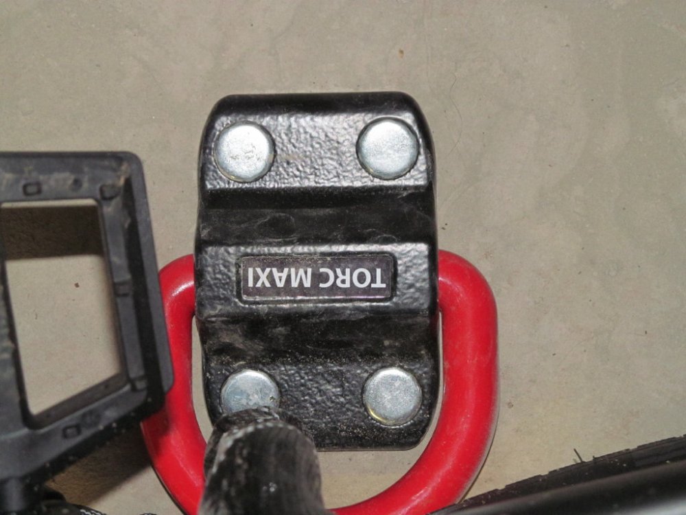

Building up another bike this time using a TSDZ2 instead of my usual BBS02.
Thinking of using the switched lighting lead provided via the controller, its a 750w 48v unit!
Measured the switched output at 6.6v, would not think this at a very high current.
Question any suitable lighting you have used or can recommend to use with the darker nights coming. Or could maybe modify to suit?IMG_20200907_132847.jpg
