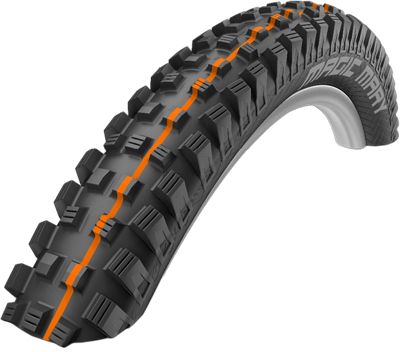

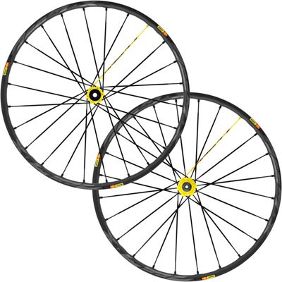

some tyres are just a loose fit and some can be near impossible to fit on the rims it just depends on what wheel set you have.
i have super gravity tyres 1.2kg and there a right pita to fit on my mavic rims but others dont have the same problem.
