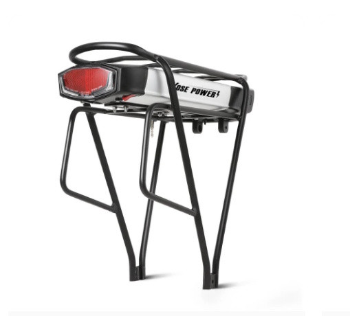

Does anyone know where I can buy something like this but for a 20" wheel bike? They all seem to be for 26" -28" bikes.
I would prefer it with the battery.
I can find normal rear racks for 20" bikes, but none for carrying batteries.
I certainly don't want to buy one of this style battery and then just gaffa tape it in place on a normal rack.
Battery+Gaffa Tape+Police never ends well.

If you look at how the battery slides in to the one you've shown, you can see that the battery holding plate is independent from the rack. It's just screwed to it. That's also true of other batteries and their holders. In that case you can fix the battery mechanism to any normal rack, which is a lot neater, but it doesn't give you the aditional rack over it to fit paniers or whatever you might want to put on a rack.
Here's one I fitted to a standard raleigh 20 rack:
63970
This is a more modern one, which you can see simply screws to what's below it. You normally have to use a couple of steel strips across the way to act as clamps. It's very simple to do, just drill a few holes for the screws.
