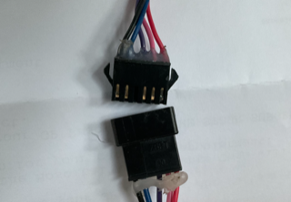

Locate the controller box and post pics of the wiring nicely laid apart and not a birds nest affair then we might be able to see if it is possible.
Regards to tyres one might be able to fit something like Scwalbe's 20" Big apple's or others they produce up to about 2 - 2.15", measure the distance between the forks stays for clearance, though one will be able to see what available clearance there is with the tyres fitted.
The rims are likely 19mm so should be no issue to fit wider tyres.

Strip down the front part of the battery holder to show us the controller and connections, someone can then advise of whether you can add a throttle

That was going to be my first step. I've wired a few contollers over the years so it's not a major issue. I'll have to strip it down, as you mentioned, and go from there. Will post some pic when I've done so.

That was going to be my first step. I've wired a few contollers over the years so it's not a major issue. I'll have to strip it down, as you mentioned, and go from there. Will post some pics when I've done so.
