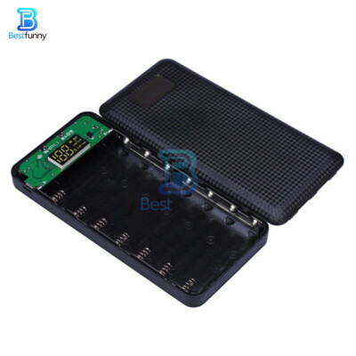

I use 18650's from older batteries like you for multiple torch use as well as for using with various other portable devices. These other devices are mainly for my beekeeping, small light power sources to vape my bees for varroa treatment or use the same packs to power my 12v beevac for extracting swarms/colonies from hard to get places.
