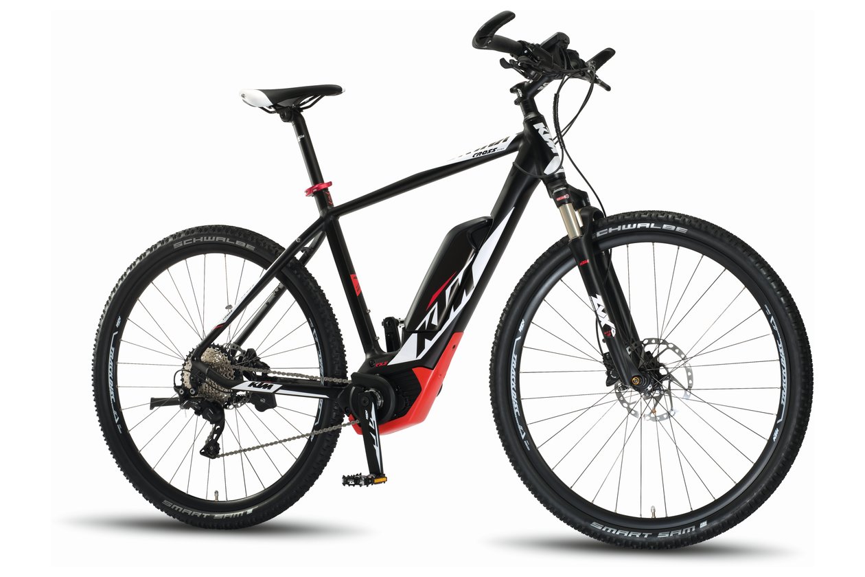

What is up with some shops this month? It seems like there must be something going around.
Here's a Bosch CX equipped bike that doesn't even come with MTB tyres from stock!!
Pity that doesn't come with proper mudguards, a rack and intergrated lights....it would be a good road bike.
Hub gears would be a bonus.....
Now that's in my opinion a nice looking bike and definitely similar to what I'm looking for but I would have thought Smart Sam's WERE mountain bike tyres?
You mean like this:
The Cross range are a stripped down, more sporty style hybrid style bike, confusingly, the Sport range of bikes are basically the same bikes are the cross, with a more road friendly tyre and the full accessory pack added.
I don't think any brand will do a CX motor, with hub gears, there are a number of reasons for this. KTM do hub gears on bikes with the Bosch performance motor.
Many Schwalbe tyres come in MTB or cross sizes, so you can use it for either.
For instance the Smart Sam comes in a massive range of sizes.
https://www.schwalbe.com/gb/offroad-reader/smart-sam.html
37-622 (28 x 1.40, 700x35C)
Is the narrowest, and very much a hybrid size.
