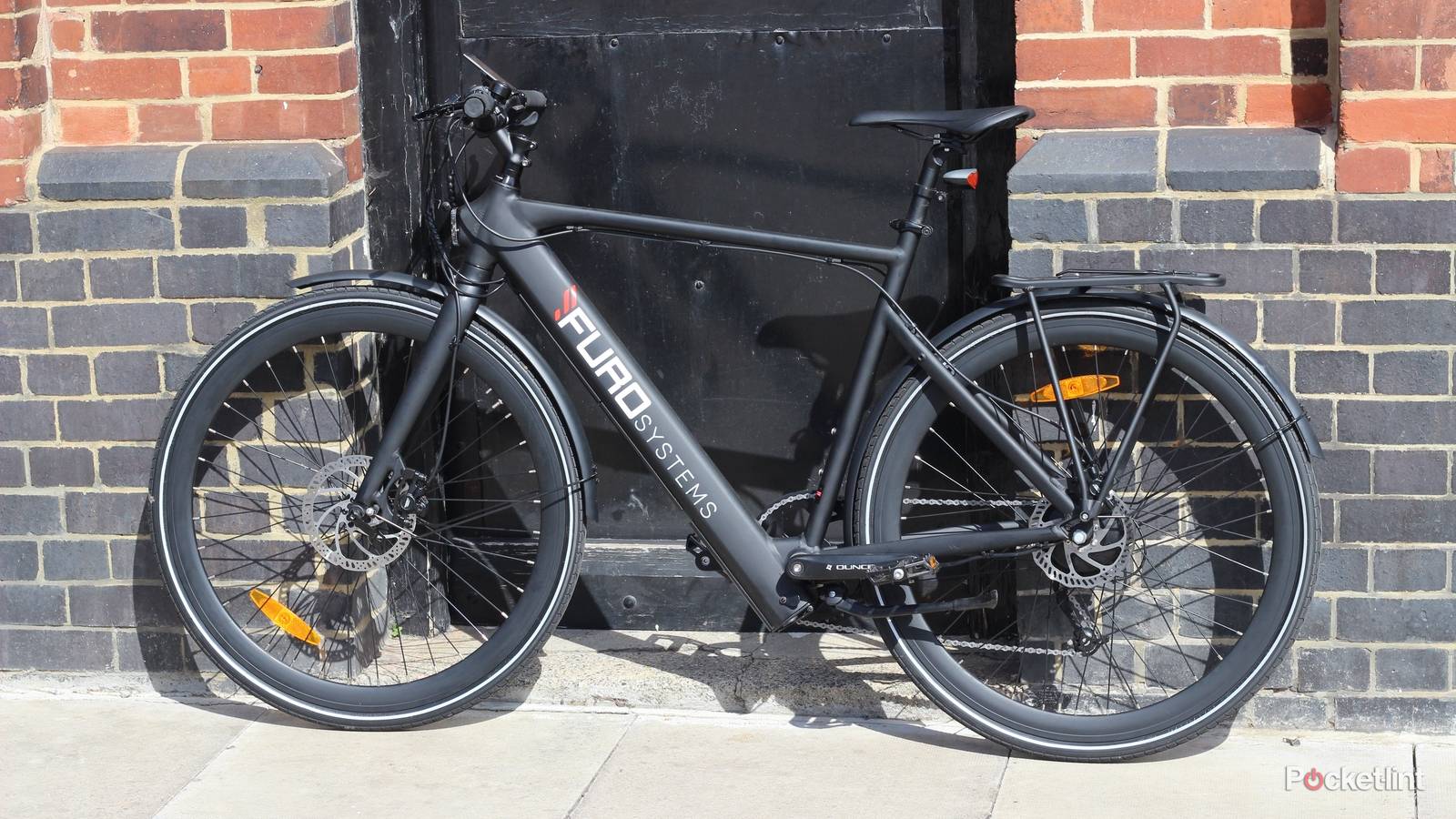

A mate of mine has the Furo Aventa e-bike and is considering changing the wheels as the existing rims are more road bike style with a deep rim and very narrow tyres fitted. This causes some problems as he is on the sturdy side and keeps getting punctures.
I guess it’s just a case of finding a suitable wheels and paying the LBS to lace the Hub motor into the rear wheel. The possible issues are that the forks are quite narrow front and rear.
Is this something that can be done without too much pain and anguish ?

Looks pretty brutal. Unfortunately, he’s not set up for tubeless and the tyres are like liquorice sticks on the edge of flying saucers. This review has better pics of the wheels than the Furo website.
