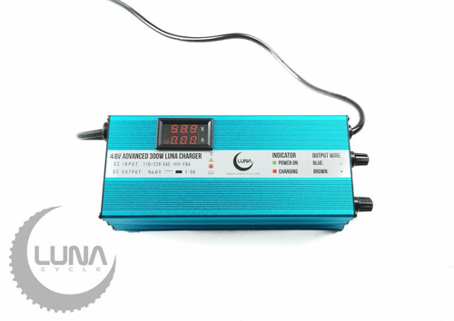

Sorry, i don't understand how to do this. In truth I was hoping to find a charger like the Luna cycles one that has the options to change the %age, and charge rate.

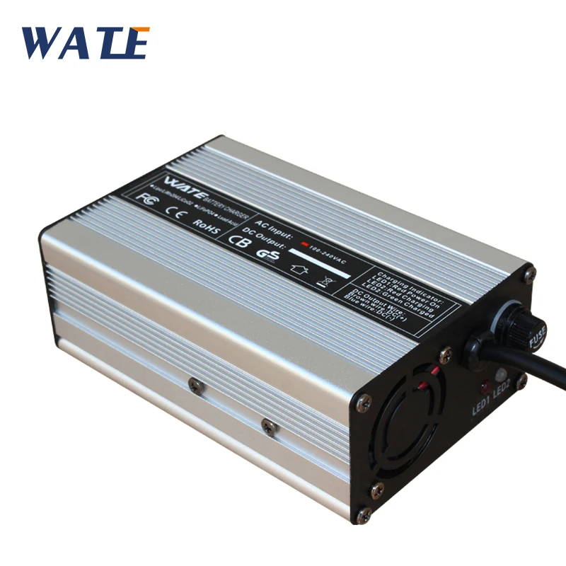

Other than Luna (~ £100) and similarly priced ones on AliExpress, and the excellent Satiator (~ £250), you could ask a favour of this seller:
48v Adjustable (97% 90% 80% and storage charge) (1AMP to 3.9AMP) Fanless waterproof ebike charger.
He's basically giving them away (I'd offer more) and he might do a 320W 5.5A version, see here for second opinions. Very portable too.

I have messaged this seller, if he doesn't come back I might do myself, as looks relatively straight forward!
