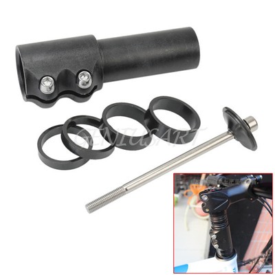

Looks like a standard 'modern' threadless headset handlebar. Rather than explain wrong I'll reference https://www.wikihow.com/Adjust-Handlebars
Sometimes not much height adjustment and you'll need a stem riser.
Lots to choose from, I bought the following which is working well for our tandem.

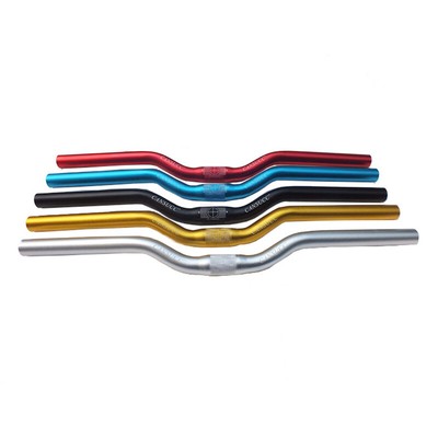

1. More spacers under the stem
2. Change the bars to riser bars
3. Change the stem to one with a higher angle or an adjustable one.
4. Use handlebar risers
5. Use a stem riser
