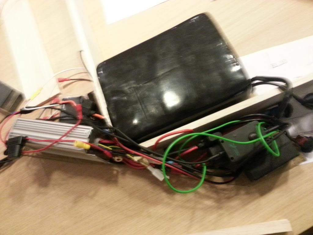

Hope you don't mind me jumping in on this thread rather than starting a new one but wondered if anyone can give me the dimensions of the molded shunt that has to be wired in between battery and controller on v.2.3 CA ?
Can't find them anywhere and still waiting for this to come :mad:. I am VERY tight on space in my box using just about every available square inch (fuse box has already had to go as no space !) but really need to get on with making it so would be a real help to have the dimensions so I can make provision for it to be inserted.
Thanks. :)

They're very small, so you shouldn't have any problem - about 15mm square and abour 6mm thick. My V2 had nice flexible wire on it, but my V3 has very stiff wire, which makes it a bit more awkward, although you only need an inch of wire on each side. Haven't you got yours yet? I got mine ages ago.
That's a huge relief, d8veh. No, don;t have it yet. But I drew the line at $55 shipping by courier versus $15 by mail. Was from Canada so I'm sure it would have been here by now if they hadn't sat on the order for 4 working days before promising to ship it :mad:
The DC-DC converters and switch boxes taking up SO much space - and that controller is HUGE there's hardly going to be an inch of room.
