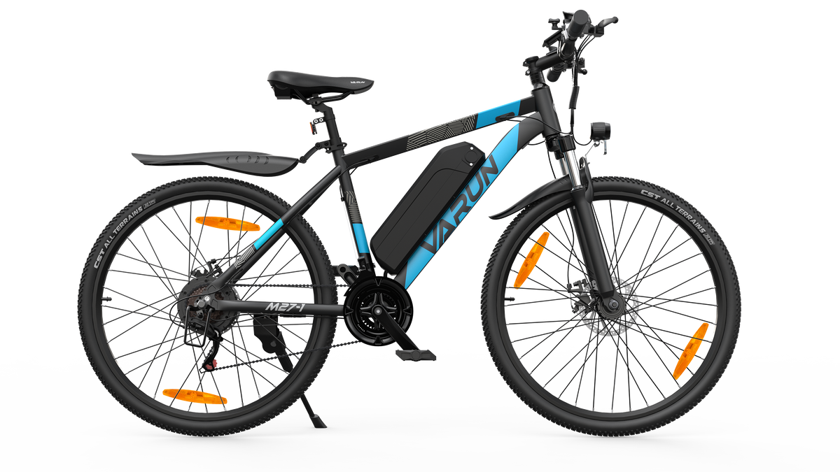

I initially was looking at the Varun M27.1 which has a 48V 13Ah battery. I checked out Amazon, Ebay , AliExpress, Varun itself and then the Varun store on Alibaba
www.varunebike.com
That was £550 on Amazon, and the cheapest I could find it was on Alibaba for £432 delivered. I looked around at any alternatives and ended up buying this Duotts C29 with 48V 15Ah battery
VARUN M27-1
VARUN Ebike for Adults - 250W Motor & 48V 13Ah Battery. Up to 100km Range at 25km/h. Smart Version Equipped with APP. Suitable for Riders 160-195cm Tall.
