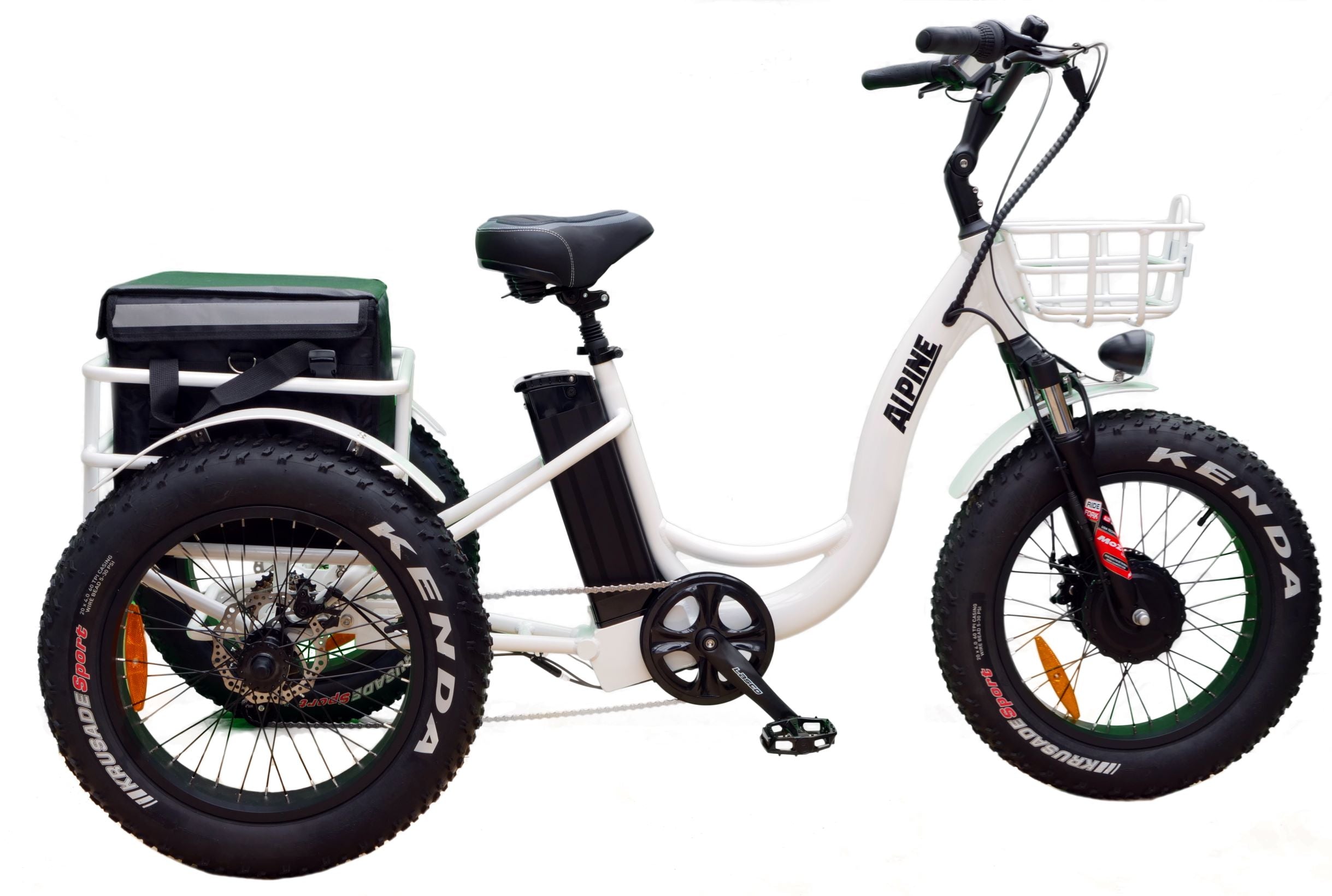

Thank you all but I'm not ready for a Recumbent Trike just yet. Still mobile , just will be a bit nervous getting up on a 2 wheeler again........Looking at an Alpine Explorer Trike ....it was the pothole that did for me..this thing should take them in its stride........I've seen a goo second hand one......
Much better carrying capacity too.
Not sure the need for knobbles on the tyres though.
Make sure you do a test ride before you buy to make sure it suits and feels stable enough.
The front motor looks a little more than 250W? Do you know the spec?

It says "250w brushless front hub motor (Bafang). High Torque". This is from the Manufacturer, I'm buying second hand, but it's the same TRIKE......I won't be able to test ride it.....It's in Sheffield......I'm In Penzance......

It's highly unlikely I'd be in any state to cycle honestly when/if 80 years old. I don't do that now lol. I'd convert something suitable rather than buy off the shelf, making absolutely certain I'd never need to put in any effort whatsoever! About 30A and 48V through a cadence sensored Bafang mid drive would be my choice. Of course I'd try to keep it legal with a 250W kit, even if I had to replace the controller with a 30A one. Failing that, a Bafang HD, laws be damned.
That bike weighs 35kg, has a 36V front hub motor - I don't think it'd be good for riding up hills, unless you're this guy:

Very interesting video, talks sense. It is a bit hilly here but `I never had problems with the other Ebikes I had, but I was a bit worried about this one.....If it doesn't work out ......then it's back to the drawing board .....maybe something with normal tyres.......

Sounds like I0kg+ might not make much of a difference to you, which is brilliant, well done for keeping fit. Hope it works out.
If it says 250W it should be ok, the motor just looks big. I would not like to splash out a lot of money on a bike without getting the chance to ride it, but it seems like you don't have much choice.
