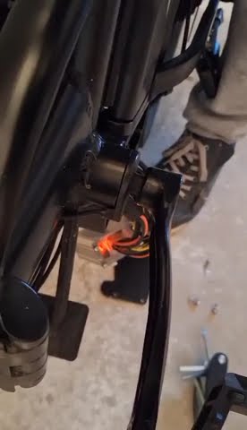

Dont understand what you want to hear. I disconnect connector from motor in order to do measurements and put back arrow against them.
Inlet into motor is according me as it should be..no visible damage
You have to push it in until the outer one reaches a ring that runs around the inner to mark how far it has to go. If you don't know about that, it's probably not in far enough.

Ok you talk about 9pin connector, yes it is pushed to the limit. But problems occured from full drive with interruptions, then 4s drive and now only 1/4 of turn...Probably nobody play sith comnectors or display settings
Does it reach the line?

yes it is strongly connected male and female .. dont think so that here is problem, .. controller doesnt have self learn wire..
but you consider resistance between plus and phase wires that is ok? because on the internet it should be infinity, or some tens of megaOhms... but if I measure it it starts from 8kOhm and increases every seconds until forever I assume.. si this value shound be increasing during time and not starts frok KILO Ohm but at least from MEGA isnt it?

One last time before I give up: Does the outer reach the line?

thanks you for your patience but yes connector is very tight ... fault starts to appear slowly... 100% driving, then 70% (interruptions during drive), then 5% (4 seconds drive) and now only 1/4 of turn of wheel..

See the line on the inner connector (circled in red) - does the outer connector push in until it reaches that line

ok thanks but it is according picture... so now we need to solve if this issue is controller
- burned mosfets?, because I have same increasing impedance between Phase and + , starting from 7kOhm to xyz kOhm
- wrong Hall sensor - after startup of rotation controller dont get proper signals and turn of motor?

You said your connector was in accordance with the picture. the picture show a gap between the line and the edge of the connector, which is NOT OK. The line should be in the same place as the edge of the connector with no gap. If that's not the cause of your problem, you either have a damaged motor cable or a connection fault at the controller end of the motor cable.

yep I understand your high assumption to connector/wiring/to hall sensors. Make sense also for me but....hm... No i cant push stronger male and female against, this vertical line is plastic stopper which doesnt allow you to move it further...

SOLVED... damaged wiring to hallsensors in motor caused by speed-magnet .... magnet disassembled , put some glue on cables as isolation and it works.
