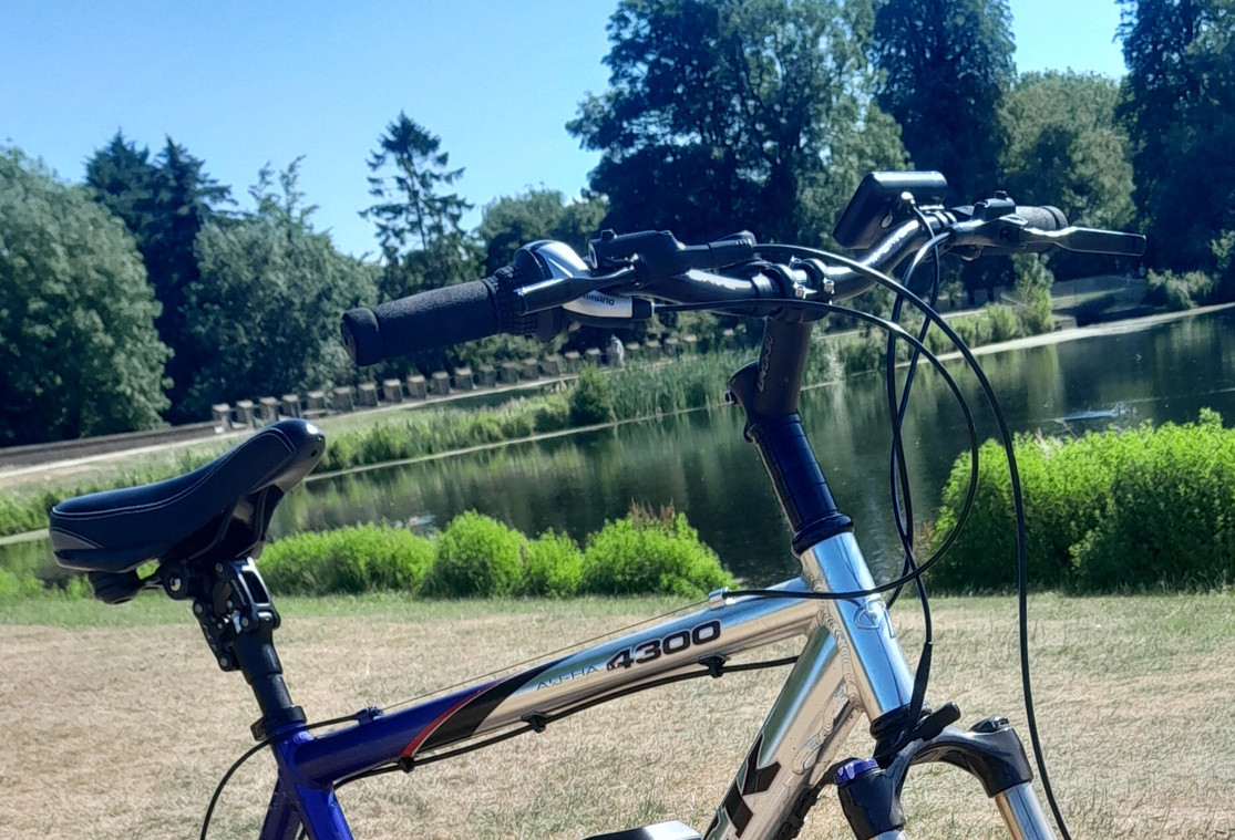

When it comes to raising handlebars, I have learnt that if one buys a new pair of forks, DO NOT CUT THE STEERER TUBE, just invest in some spacers. You can cut the steerer tube later later if you want to lower your handlebars, but it's much harder to raise the handlebars later if you change your mind.
And it seems to me, a lot of people complain that their handlebars are too low and it makes their wrists ache. No one ever seems to complain that their handlebars are too high.
My steerer tube with a bunch of spacers:
